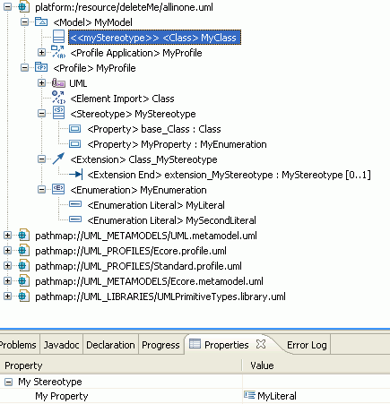

I have a Model on which I apply a Profile. The model and the profile and
saved in the same unique file.
The profile defines a stereotype with a property whose type is an
enumeration, defined in this profile as well.
This stereotype is applied to an instance of the model, an the property is
set to an enumeration literal.
No problem to save this model. The file format looks good, all necessary
information is there.
But I get a ClassCastException when a reload the resource.
This is because the resource is loaded using
XMLResource.OPTION_DEFER_IDREF_RESOLUTION=true (in UMLResourceFactoryImpl).
By the time the xmi reader try to set the value of the property, the type
of this property is not already set (forward references are not resolved,
we did not reached the end of the document).
I suspect this problem would be solved by saving this profile in another
resource, but I need the ability to save the model and the applied profile
in one unique file.
Using Eclipse 3.2.1, EMF 2.2.1, UML2 2.0.1.
Here is the uml model:

Any help would be appreciated,
Sebastien

Hi Sebastien,
It is being looked into. Saving model and profile in one file should work.
- James.

Re: Profile with enumeration in same file as model -> ClassCastException [message #470247 is a reply to message #470243] Sun, 11 February 2007 20:37 Go to previous messageGo to next message
Hi Sebastien,
I'm seeing this stack trace..
java.lang.ClassCastException: org.eclipse.emf.ecore.impl.EAttributeImpl
at
org.eclipse.emf.ecore.xmi.impl.XMLHandler.setAttribValue(XML Handler.java:2559)

With slight modifications I can open the model and can see the following .
Please raise a defect and this will be taken care of.
Regards.
- James.

Re: Profile with enumeration in same file as model -> ClassCastException [message #586845 is a reply to message #470243] Sun, 11 February 2007 20:37 Go to previous message
Hi Sebastien,
Regards.
- James.
