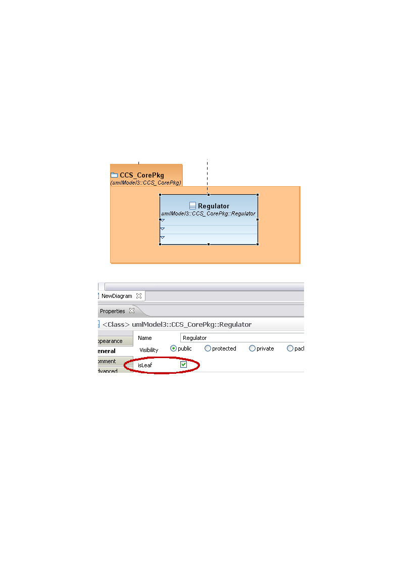

Re: Is there anybody who use Papyrus UML? [message #469039 is a reply to message #469036] Fri, 19 December 2008 09:22 Go to previous messageGo to next message
in UML2, I think that this concept is supported by the isLeal attribute of a
RedefinableElement. So for a Class (which is RedefinableElement) in Papyrus,
you just need to check the check box of the isLeaf properties as shown in
attached picture.
Regards... S
  • Attachment: LeafClass.png
    (Size: 27.59KB, Downloaded 251 times)
Re: Is there anybody who use Papyrus UML? [message #469041 is a reply to message #469039] Fri, 19 December 2008 10:55 Go to previous message
Actually, I believe that for Java's final *fields*, it would correspond
to StructuralFeature.isReadOnly ("whether the feature's value may be
modified by a client").
RedefinableElement.isLeaf ("whether it is possible to further specialize
a RedefinableElement") seems to correspond to Java's final classes or
methods.
So I guess the question is whether Papyrus exposes isReadOnly for
structural features.
Rafael

Re: Is there anybody who use Papyrus UML? [message #575420 is a reply to message #469036] Fri, 19 December 2008 09:22 Go to previous message
attached picture.
Regards... S
    (Size: 27.59KB, Downloaded 207 times)
Re: Is there anybody who use Papyrus UML? [message #575457 is a reply to message #469039] Fri, 19 December 2008 10:55 Go to previous message
methods.
Rafael
