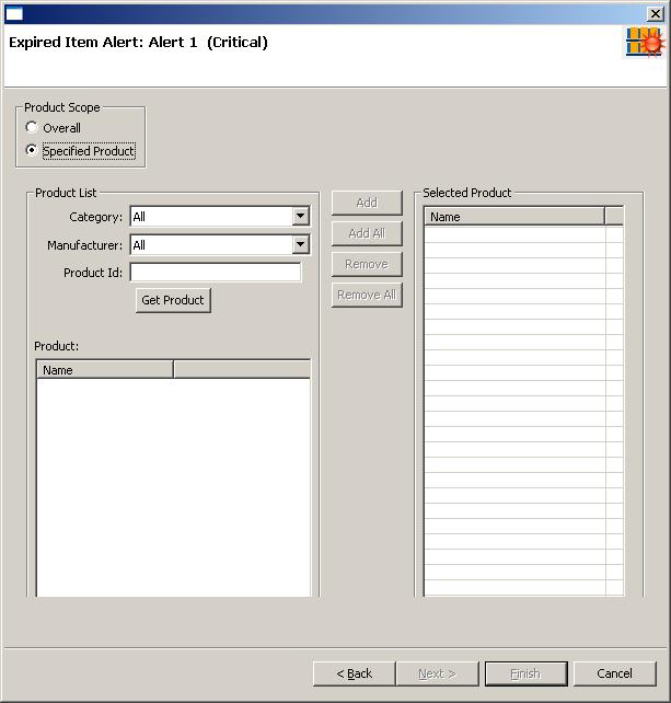

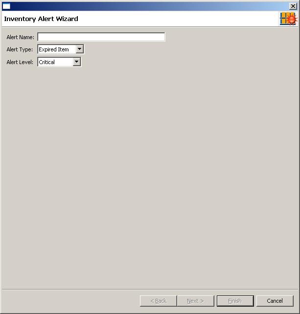

When I click next on page 1, and go to page 2, about 20 pixels of
height in the botton group control are clipped. (That is, they are sitting
underneath that "gray" space between my controls, and the button bar line.
(See attachments)
Here is what caused my controls to be clipped.
Because on page 1, I called setDescription(""), the "title area" of
the dialog shrunk down in size so only the "First wizard page" text and the
image are visible.
Then on page 2, since I didn't call setDescription(""), that title
area expands downward, pushing the "content area" of the second wizard page
down, but not resizing the whole wizard dialog...hence the bottom of my
controls are cut off.
So, if there were to be a bug here, I'd say that it would be that
when the total size of the wizard dialog for all pages is being calculated,
The maximum size of the title area is not be calculated...it's
using like the size of the first page or something. This is not
withstanding the
fact that my call to setDescription on page one is unnecessary,
and bogus.
And also, by the way, this behavior was conistent across Win32 and
Linux/GTK.
I attached two screen shots of the first two pages to show you
what I mean. Notice on the first page the top title area is shrunken down
(via the setDescription(""), and the second page is not.
The fix ultimately was to remove the bogus call to
setDescription("")...
Anyway, any of the SWT folks think this is a bug, or is it acting
as designed?
Joe
  • Attachment: page2.jpg
    (Size: 45.06KB, Downloaded 227 times)
  • Attachment: page1.jpg
    (Size: 23.45KB, Downloaded 205 times)

Btw, depending on your news browser, my pages may be reveresed in the
attachments. The
first page is the one with the edit control, and the 2 combo boxes. The
second page is
the one that has a lot of controls in it.
Joe
