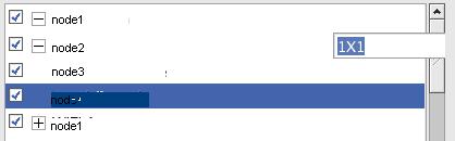

Hi All,
I have a tabletreeviewer with SWT.CHECK style
This tree looks good on win 2k but looks improper in fedora core 3
I means on fedora the nodes at verious levels of tree should get indented to
right. The tree hirarchy should get clear.
I m attaching the sample pic.
See that node1 has child node2 which has also a child node3
The relation between node1 and node2 does not get seen properly wheare as
the relation between node2 and node3 is clear deu to indentation !
Any clue ?
~Preetam
  • Attachment: tree.jpg
    (Size: 7.90KB, Downloaded 193 times)

tabletree is apparently deprecated for issues such as this (lots of
discussions earlier in this newsgroup on it)
your best bet is to switch to a Tree with TreeColumns - the good news is
that it's "almost" a drop-in replacement :)

my bad, you'd need to use the TreeViewer rather than the TableTreeViewer:
TreeViewer viewer = new TreeViewer(parent, style);
Tree tree = viewer.getTree();
TreeColumn column0 = new TreeColumn(tree, SWT.LEFT);
column0.setText("col 0");
column0.setMoveable(true);
column0.pack();
TreeColumn column1 = new TreeColumn(tree, SWT.RIGHT);
column1.setText("col 1");
column1.setMoveable(true);
column1.pack();
your content providers shouldn't need to change:
viewer.setContentProvider( ITreeContentProvider );
viewer.setLabelProvider( ITableLabelProvider );
