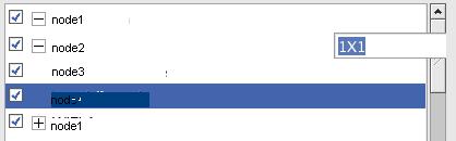

Re: Problem with TableTreeViewer and CheckboxTreeViewer -- HELP NEEDED! [message #464969 is a reply to message #463770] Fri, 02 December 2005 07:03 Go to previous messageGo to next message
Originally posted by: preetamp.aftek.com
Thanks !
I did that
But now i have one more problem !
The tree i created looks good on windows 2K
but does not look proper on Linux Fedora core 3
I means on fedora the nodes at verious levels of tree should get indented to
right. The tree hirarchy should get clear.
I m attaching the sample pic.
See that node1 has child node2 which has also a child node3
The relation between node1 and node2 does not get seen properly wheare as
the relation between node2 and node3 is clear deu to indentation !
Any clue ?
~Preetam

Re: Problem with TableTreeViewer and CheckboxTreeViewer -- HELP NEEDED! [message #465094 is a reply to message #464969] Mon, 05 December 2005 16:54 Go to previous message
This is a known problem on GTK - indentation is not supported. This is why
in 3.1 we deprecated TableTree and added support for Tree with TreeColumn.
See:
http://dev.eclipse.org/viewcvs/index.cgi/org.eclipse.swt.sni ppets/src/org/eclipse/swt/snippets/Snippet170.java?rev=HEAD& amp;content-type=text/vnd.viewcvs-markup
TreeViewer also supports TreeColumn.
