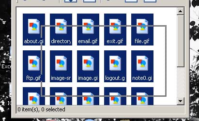

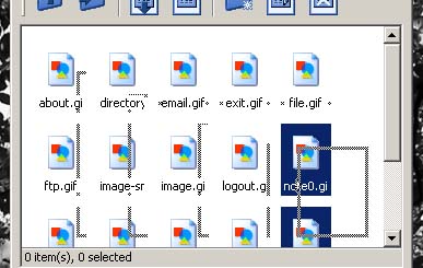

(See the screenshots in the attachments).
If I select a number of icons (att: drag_select.jpg), and the downsize the
tracker again so that some of the selected Icons are deselected again
(drag_deselect.jpg), the Tracker leaves its trace on the IconComposites!
The faster the deselection is occured, the more "trace marks" I get. The

Mani Ghamari
Re: Trackers / Rubber bands - Attachments [message #447255 is a reply to message #447254] Fri, 10 December 2004 13:00 Go to previous message
Oops, I forgot the attachments ;)
here they go...
