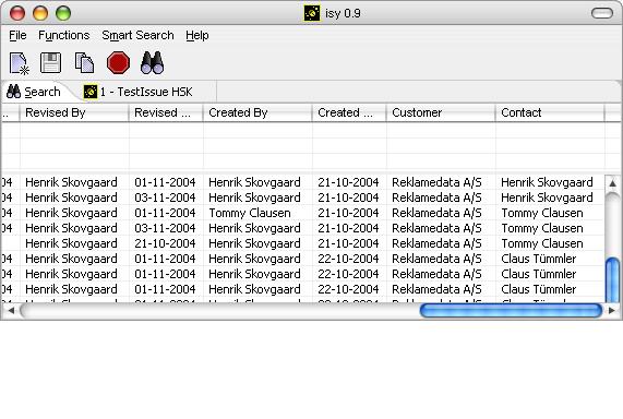

I have a slight problem with getting my scrollbars to behave like I want
them to do. I think I need some guidelines here.
I am working on an application that has the following structure of the gui
(see also attached picture):
Composite
-> ToolBar
-> CTabFolder
-> CTabItem
->ScrolledComposite
->SashForm
->TableA
->TableB
First of all, the right vertical scrollbar is on TableB only - as I want it
to, but I have to scroll all the way to the right to see it. I want this
scrollbar to be visible on the right edge whenever it is needed so I don't
have to scroll to see it.

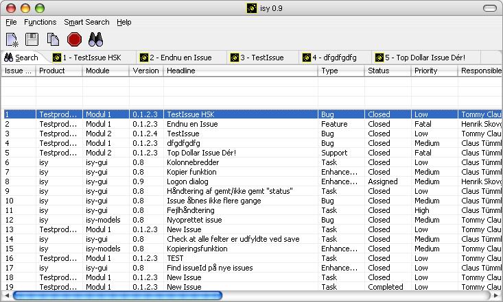

Second, when I resize the window, the horizontal scrollbar is just ignoring
this so to speak. So I have to scroll or drag the scrollbar underneath the
visible area to see the buttom of TableB (see other picture attached).
I hope some of you can give me some hints to fix this :-)
/Henrik

Why are you using a ScrolledComposite here? Just let the tables provide
their own scrollbars.

I want the two tables to be scrolled at the same time. So scrolling the
lowest scrollbar alsp scrolls the uppermost table.
/Henrik
