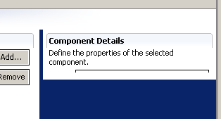

I'm creating a details page of the master/details block and I'm experiencing
layout problem. When I resize a sash between master and details, somewhere
on the edge when a section description text is about to wrap, the name and
value fields of the section disappear (see attachement). For some reason the
section does not resize the height properly. If I try to make the section
even smaller, everything becomes fine again. There is an about 5 pixels area
of abnormality.
Any idea?
  • Attachment: shot.bmp
    (Size: 155.85KB, Downloaded 126 times)

Can you give some code to show how you are laying out your page?
Here it comes:
public void createContents(Composite parent) {
TableWrapLayout layout = new TableWrapLayout();
layout.topMargin = 0;
layout.leftMargin = 5;
layout.rightMargin = 0;
layout.bottomMargin = 0;
parent.setLayout(layout);
Section section = toolkit.createSection(parent, Section.TITLE_BAR |
Section.DESCRIPTION);
section.setText(title);
section.setDescription(description);
section.marginWidth = 5;
section.marginHeight = 5;
TableWrapData td = new TableWrapData(TableWrapData.FILL,
TableWrapData.TOP);
td.grabHorizontal = true;
section.setLayoutData(td);
Composite client = toolkit.createComposite(section);
GridLayout glayout = new GridLayout();
glayout.marginWidth = 2;
glayout.marginHeight = 4;
glayout.numColumns = 2;
client.setLayout(glayout);
section.setClient(client);
Label label = toolkit.createLabel(client, label);
GridData gd = new GridData(GridData.VERTICAL_ALIGN_CENTER);
label.setLayoutData(gd);
Text text = toolkit.createText(client, "");
gd = new GridData(GridData.HORIZONTAL_ALIGN_FILL);
gd.horizontalSpan = 1;
gd.grabExcessHorizontalSpace = true;
text.setLayoutData(gd);
text.setData(FormToolkit.KEY_DRAW_BORDER, FormToolkit.TEXT_BORDER);

The bug seems to be in ExpandableLayout.layout. When determining the height
of the description for allocating the space required, it uses one width but
when it actually sets the size of the description label it recomputes the
size and uses a width that is about 10 pixels smaller. As a result, the
smaller width causes the label to wrap and the label becomes taller than
expected.
Please enter a bug report against Platform UI.
