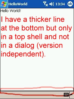

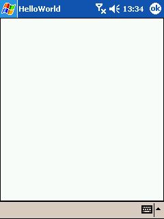

I have a problem with newer SWT versions (3.0.1 Thu, 16 Sep 2004 is the last
without problems 'old version.jpg') on Pocket PC.
They show no shell content if not the additional shell.layout(); is set
(please see HelloWorld.java in the attachment).
Does anybody have the same problem?
Then my top shells have independent of the version a thicker line at the
bottom (see picture). This looks not so good. Take notice of that dialogs
have not this thicker line. You can see this better if you zoom in.
Regards, Tobi

https://bugs.eclipse.org/bugs/show_bug.cgi?id=71975 ?

opened https://bugs.eclipse.org/bugs/show_bug.cgi?id=76102
thanks
Chris
