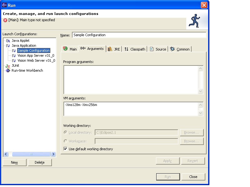

Originally posted by: mkl.inter.net.il
You can specify this kind of options in the launch configuration of your
application. See attached example. Of course, 512M memory is not enough for
every application.

  • Attachment: launch.jpg
    (Size: 76.90KB, Downloaded 505 times)
