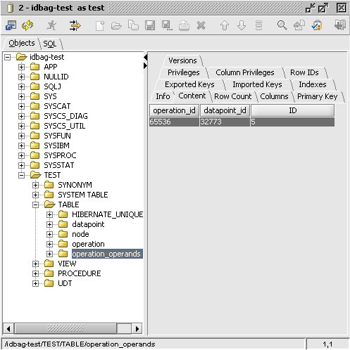

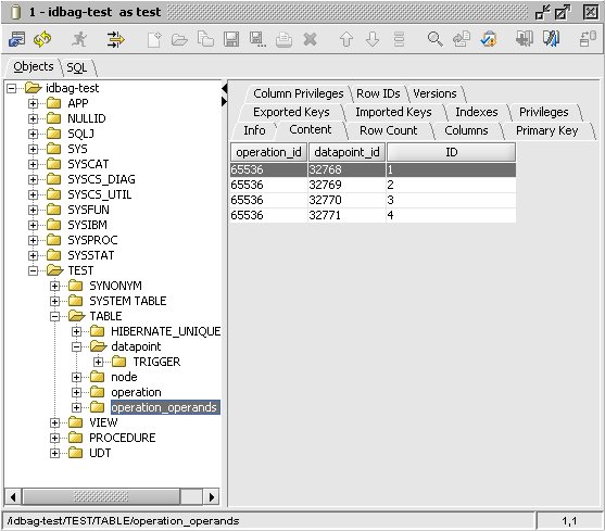

Re: [Teneo] Possible inconsistency using IdBags [message #425979 is a reply to message #425961] Mon, 15 December 2008 05:13 Go to previous messageGo to next message
Hi Martin,
I extracted the concerned (simplified) objects from my project and packed
them into another simpler plugin application. See attached zip.
When you run the Activator the first time it will create the DB and the
initial model. The second time it will remove the "operands" and add them
again together with a new "operand reference".
I attach two screenshots showing the database table after the first run and
after the second run. As you can see after the first run there are 4
"operands" in the table. After the second run I would expect the same
"operands" there plus the additional one but there is only the additional
one! I can reproduce this behaviour also omitting adding the additional
"operand". Then after the second run the table will be empty.
Greetings
Bjoern

> Hi Martin,
> Greetings
> Bjoern

Re: [Teneo] Possible inconsistency using IdBags [message #426099 is a reply to message #426082] Tue, 16 December 2008 05:45 Go to previous messageGo to next message
Hi Martin,
You are right: I cannot reproduce this error with mysql.
I've tested with derby, mysql, hsqldb and oracle. Attached you will find the
logs from each test starting from the point where list.clear() was called.
It seems that this erroneous behaviour only occurs when using Derby
database. This is very unfortunate for me as I am using the Derby database
(version 10.4.2)!

"Martin Taal" <mtaal@elver.org> schrieb im Newsbeitrag
news:gi6dh2$nfp$1@build.eclipse.org...
> Hi Bjoern,
> I used your project but I am afraid that with me it worked fine. See the
> before and after jpg's. Two
> things I changed:
> - I changed the Activator to work from a main method, which was easier to
> run (see the attached file)
> - I use mysql
> I am using Hibernate 3.2.6 which you also tried I think.
> I am a bit at a loss why it fails with you and not with me...
> Can you check the hibernate log4j output specifically at the point that
> the collection is cleared
> and then saved?
> gr. Martin
> Bjoern Sundin wrote:
>> Hi Martin,
>> and

Re: [Teneo] Possible inconsistency using IdBags [message #426119 is a reply to message #426099] Tue, 16 December 2008 15:26 Go to previous messageGo to next message
Hi Bjorn,
Thanks for checking this, I will add this to the troubleshooting area of the docs.
gr. Martin
> Hi Martin,
> (version 10.4.2)!
> AFAICS is the key to the problem on row 46 and 47 in the derby.log:
> <quote>
> [main] DEBUG org.hibernate.SQL - select max(ID) from "operation_operands"
> [main] DEBUG org.hibernate.id.IncrementGenerator - first free id: 1
> <unquote>
> I put a breakpoint in the modified the IncrementGenerator getNext-method and
> changed the value of next id from 1 to 5 (like in the other logs). After
> this manipulation also the Derby database was consistent! See
> derby-manipulated.log.
> This doesn't really make sense to me, as it would mean that with the Derby
> database the delete of rows got persisted to the database before the query
> for max(ID) whereas for the other databases it's done afterwards. I guess
> this is rather a Derby driver problem, but other user of the framework might
> as well be affected and should beware of the consequences using the IDBAG
> setting in combination with Derby!
> Greetings
> Bjoern
>>> and
>>> Greetings
>>> Bjoern
>>> and
>>> Greetings
>>> Bjoern

>>>>> - I edit the list for the Library with id 2 in the GUI. I want to add a
>>>>> Book
>>>>> reference with id 12.
>>>>> - The logic makes list.clear() and thus removes all the Book references
>>>>> (11
>>>>> and 13) for the Library with id 2.
>>>>> - Then it adds the Book references 11, 12 and 13
>>>>> - The transaction gets committed.
>>>>> - The Model (EObjects) shows the following two lists:
>>>>> 1{11, 12, 13}
>>>>> 2{11, 12, 13}
>>>>> - In the database I have the following:
>>>>> 1|11|1
>>>>> 1|12|2
>>>>> 1|13|3
>>>>> 2|12|4
>>>>> - The expected result in the database would be
>>>>> 1|11|1
>>>>> 1|12|2
>>>>> 1|13|3
>>>>> 2|11|4
>>>>> 2|12|5
>>>>> 2|13|6

>> private static void handleModel() {
>> SessionFactory sessionFactory = dataStore.getSessionFactory();
>> // Open a new Session and start Transaction.
>> Session session = sessionFactory.openSession();
>> Transaction transaction = session.beginTransaction();
>> Query query = session.createQuery("FROM Node");
>> List<?> entities = query.list();
>> if (entities.isEmpty()) {
>> Node node = ModelFactory.eINSTANCE.createNode();
>> node.setName("Node 1");
>> Operation operation = ModelFactory.eINSTANCE.createOperation();
>> operation.setName("Operation");
>> node.getOperations().add(operation);
>> for (int i = 0; i < 10; i++) {
>> Datapoint datapoint = ModelFactory.eINSTANCE.createDatapoint();
>> datapoint.setName("Datapoint " + i);
>> node.getDatapoints().add(datapoint);
>> if (i < 4) {
>> operation.getOperands().add(datapoint);
>> session.save(node);
>> } else {
>> Node node = (Node) entities.get(0);
>> List<Datapoint> operands = new ArrayList<Datapoint>(0);
>> Operation operation = node.getOperations().get(0);
>> for (Datapoint operand : operation.getOperands()) {
>> operands.add(operand);
>> Datapoint anotherOperand = node.getDatapoints().get(5);
>> operands.add(anotherOperand);
>> operation.getOperands().clear();
>> operation.getOperands().addAll(operands);
>> transaction.commit();
>> session.close();
