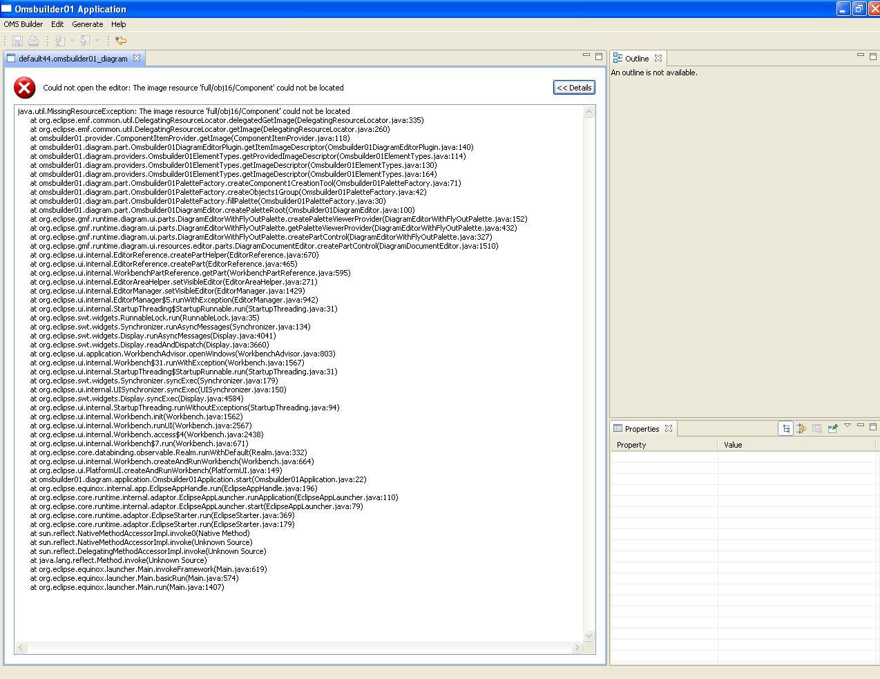

Hi All,
As I am facing problem in creating a working exe file for a plugin project.
I have created a plugin project and I was trying to create an executable of it but after creating when I launch exe, I get the error which says that it is Missing resource "not able to locate an image resource".
Please find the image that shows the error when I launch exe file.
Vinay

Re: Missing resource for XSDWildCard [message #734412 is a reply to message #734389] Fri, 07 October 2011 12:31 Go to previous messageGo to next message
Does this image exist in your generated *.edit project?

Re: Missing resource for XSDWildCard [message #734823 is a reply to message #734818] Mon, 10 October 2011 01:26 Go to previous messageGo to next message
Does the editor plugin delegate to the bundle that contains the image?

Re: Missing resource for XSDWildCard [message #734827 is a reply to message #734823] Mon, 10 October 2011 02:01 Go to previous messageGo to next message
Okay I just resolved it.
The problem was with the extension of the image. It was .GIF, I changed it to .gif...
But when I run it in another system it says that "The publisher could not be verified" and when I click on run button nothing happens.
Vinay
