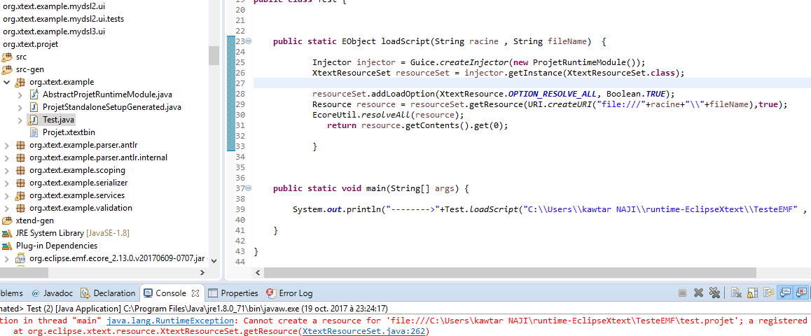

Re: " java.lang.RuntimeException: Cannot create a resource for 'file:///C:\Users\kawtar NAJI\ru [message #1774817 is a reply to message #377408] Thu, 19 October 2017 18:33 Go to previous messageGo to next message
I want to go from an xtext model to its EMF model but i got this exception can anyone help me to solve this problem.
thanks in advance .

Re: " java.lang.RuntimeException: Cannot create a resource for 'file:///C:\Users\kawtar NAJI\ru [message #1774888 is a reply to message #1774848] Fri, 20 October 2017 16:06 Go to previous messageGo to next message

Your visual snippet has so many things that make me uncomfortable I'm not sure where to start.
But first, do not attach a new problem to a 14 year old thread. Software moves much to fast for there to be any sensible prospect that your new problem is a continuation.
Do not use visual snippets. Your code cannot be cut and paste as a mini repro. Your exceptions are hideously truncated forcing major guessing. Why not cut and paste so that we see it all and Google searches can find similar content?
I am a Windows user, but I never use "\" in code. "/" works fine in all C/Java based software.
I suspect that your problem is "file:///". I would need to read the specification to be sure what it actually means. URI.createFileURI is so much easier.
Ed Willink

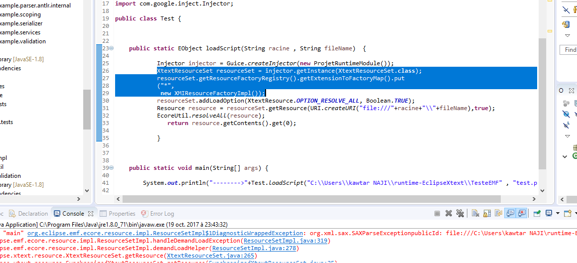

Re: " java.lang.RuntimeException: Cannot create a resource for 'file:///C:\Users\kawtar NAJI\ru [message #1774930 is a reply to message #1774910] Sat, 21 October 2017 10:20 Go to previous messageGo to next message
this is what happen when i remove the file:///
Exception in thread "main" org.eclipse.emf.ecore.resource.impl.ResourceSetImpl$1DiagnosticWrappedException: java.net.MalformedURLException: unknown protocol: c
at org.eclipse.emf.ecore.resource.impl.ResourceSetImpl.handleDemandLoadException(ResourceSetImpl.java:319)
at org.eclipse.emf.ecore.resource.impl.ResourceSetImpl.demandLoadHelper(ResourceSetImpl.java:278)
at org.eclipse.xtext.resource.XtextResourceSet.getResource(XtextResourceSet.java:265)
at org.eclipse.xtext.resource.SynchronizedXtextResourceSet.getResource(SynchronizedXtextResourceSet.java:25)
at org.xtext.example.Test.loadScript(Test.java:40)
at org.xtext.example.Test.main(Test.java:65)

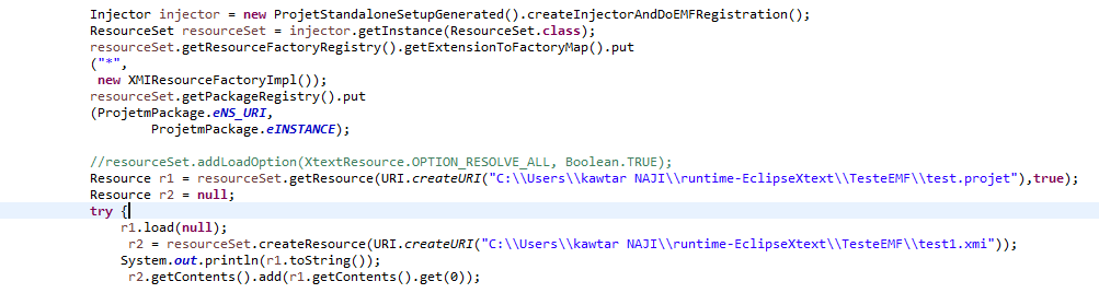

Re: " java.lang.RuntimeException: Cannot create a resource for 'file:///C:\Users\kawtar NAJI\ru [message #1774931 is a reply to message #1774930] Sat, 21 October 2017 10:30 Go to previous messageGo to next message
this is my code :
package org.xtext.example;

public static void loadScript() {
Injector injector = new ProjetStandaloneSetupGenerated().createInjectorAndDoEMFRegistration();
ResourceSet resourceSet = injector.getInstance(ResourceSet.class);
resourceSet.getResourceFactoryRegistry().getExtensionToFactoryMap().put
new XMIResourceFactoryImpl());
resourceSet.getPackageRegistry().put
(ProjetmPackage.eNS_URI,
ProjetmPackage.eINSTANCE);
//resourceSet.addLoadOption(XtextResource.OPTION_RESOLVE_ALL, Boolean.TRUE);
Resource r1 = resourceSet.getResource(URI.createURI("file:///C:\\Users\\kawtar NAJI\\runtime-EclipseXtext\\TesteEMF\\test.projet"),true);
Resource r2 = null;
try {
r1.load(null);
r2 = resourceSet.createResource(URI.createURI("file:///C:\\Users\\kawtar NAJI\\runtime-EclipseXtext\\TesteEMF\\test1.xmi"));
System.out.println(r1.toString());
r2.getContents().add(r1.getContents().get(0));
r2.save(null);
EcoreUtil.resolveAll(r1);
} catch (IOException e) {
// TODO Auto-generated catch block

Re: " java.lang.RuntimeException: Cannot create a resource for 'file:///C:\Users\kawtar NAJI\ru [message #1774932 is a reply to message #1774931] Sat, 21 October 2017 11:47 Go to previous messageGo to next message
"URI.createFileURI is so much easier."
Re: " java.lang.RuntimeException: Cannot create a resource for 'file:///C:\Users\kawtar NAJI\ru [message #1774933 is a reply to message #1774931] Sat, 21 October 2017 11:48 Go to previous messageGo to next message
As was already suggested a \ in a URI is a bad idea because it is NOT a path separator in a URI, it's a path separator only on Windows and only as far as java.io.File is concerned. Generally when using file-based access, use URI.createFileURI(file.getAbsolutePath())) to create the URI from the java.io.File. Make sure it's absolute.
Re: " java.lang.RuntimeException: Cannot create a resource for 'file:///C:\Users\kawtar NAJI\ru [message #1791510 is a reply to message #1774933] Sun, 01 July 2018 09:26 Go to previous messageGo to next message
