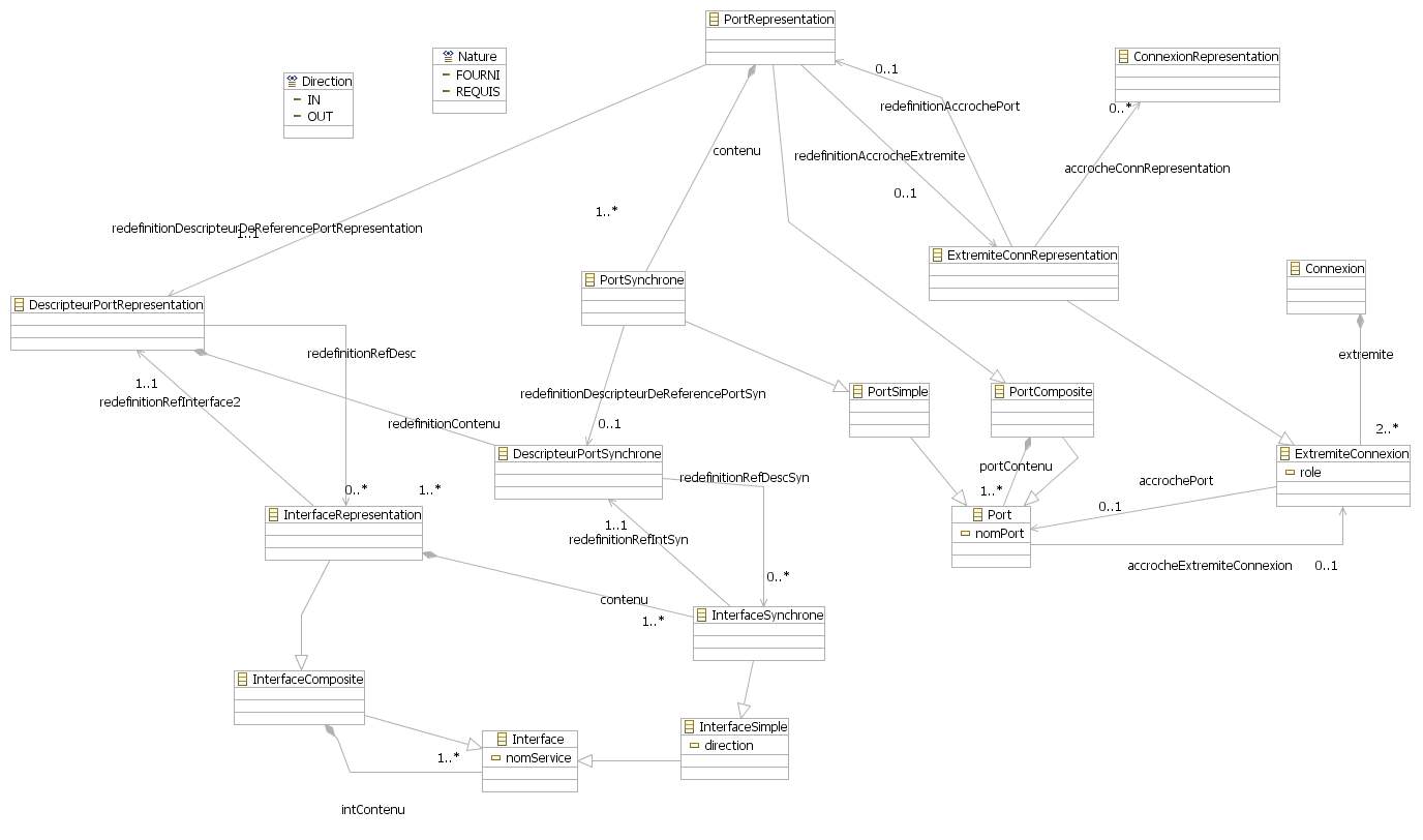

here a little more explanations ! to see the drawing
The ExtremiteConnRepresentation class represents a connection between nodes
(diagram gmf) and ExtremiteConnexion.role is a label.
when I create my connection, I want to initialize my ExtremiteConnexion.role
with 'emetteur' or ' receveur' according to InterfaceSimple.direction ! if
direction='IN' then role='receveur' else role='emetteur'
I try this :
context ExtremiteConnRepresentation
if
self.redefinitionAccrochePort.contenu.redefinitionDescripteu rDeReferencePort
Syn.redefinitionRefDescSyn.direction='IN' then self.role='receveur' else
self.role='emetteur' endif
and I had this error message :
Invalid expression body 'if
self.role='emetteur' endif'. Cause: Invalid expression body 'if
self.role='emetteur' endif'. Cause: ERROR in (operationCallExpCS): (Cannot
find operation (=(String)) for the type (Sequence(Direction)))
thank you very much !!!
"Christian W. Damus" <cdamus@ca.ibm.com> a
  • Attachment: model.jpeg
    (Size: 75.33KB, Downloaded 325 times)
Re: check an attribute [message #37479 is a reply to message #37445] Thu, 20 September 2007 10:56 Go to previous messageGo to next message
Originally posted by: cdamus.ca.ibm.com
Hi, Briand,
I see. "Direction" is an enumeration type, so you need to reference its
literal values by name:
if
self.redefinitionAccrochePort.contenu.redefinitionDescripteu rDeReferencePortSyn.redefinitionRefDescSyn.direction=Directi on::IN
then
else
endif
HTH,
Christian

Re: check an attribute [message #37545 is a reply to message #37514] Thu, 20 September 2007 17:37 Go to previous messageGo to next message
Hi, Briand,
Right. The problem is, that (evidently) the following expression results in
a collection of Direction values:
because at least one of the following properties has multiplicity many (is
collection-valued):
- redefinitionAccrochePort
- contenu
- redefinitionDescripteurDeReferencePortSyn
- redefinitionRefDescSyn
Apply the "." operator to navigate the property of a collection value
implicitly iterates the collection using the "collect" iterator, so that
the result is another collection.
You will need to do either:
self.redefinitionAccrochePort.contenu.redefinitionDescripteu rDeReferencePortSyn.redefinitionRefDescSyn.direction- >forAll(d
| d = Direction::IN)
to assert that all directions are "in" or, if you expect that there will
only be one direction in the collection value:
self.redefinitionAccrochePort.contenu.redefinitionDescripteu rDeReferencePortSyn.redefinitionRefDescSyn.direction- >first()
= Direction::IN
HTH,
Christian
> in
>> (is collection-valued):
>> - contenu
> Syn.redefinitionRefDescSyn.direction->forAll(d
>> | d = Direction::IN)
> Syn.redefinitionRefDescSyn.direction->first()
>> = Direction::IN
>> HTH,
>> Christian
>> briand wrote:
>> > thank you for your assistance but it always has an error !
>> > error :
>> > Syn.redefinitionRefDescSyn.direction=Direction::IN then
>> > self.role='receveur' else self.role='emetteur' endif
>> > '. Cause: ERROR in (operationCallExpCS): (Cannot find operation
>> > (=(Direction)) for the type (Sequence(Direction)))
>> ------8<------
