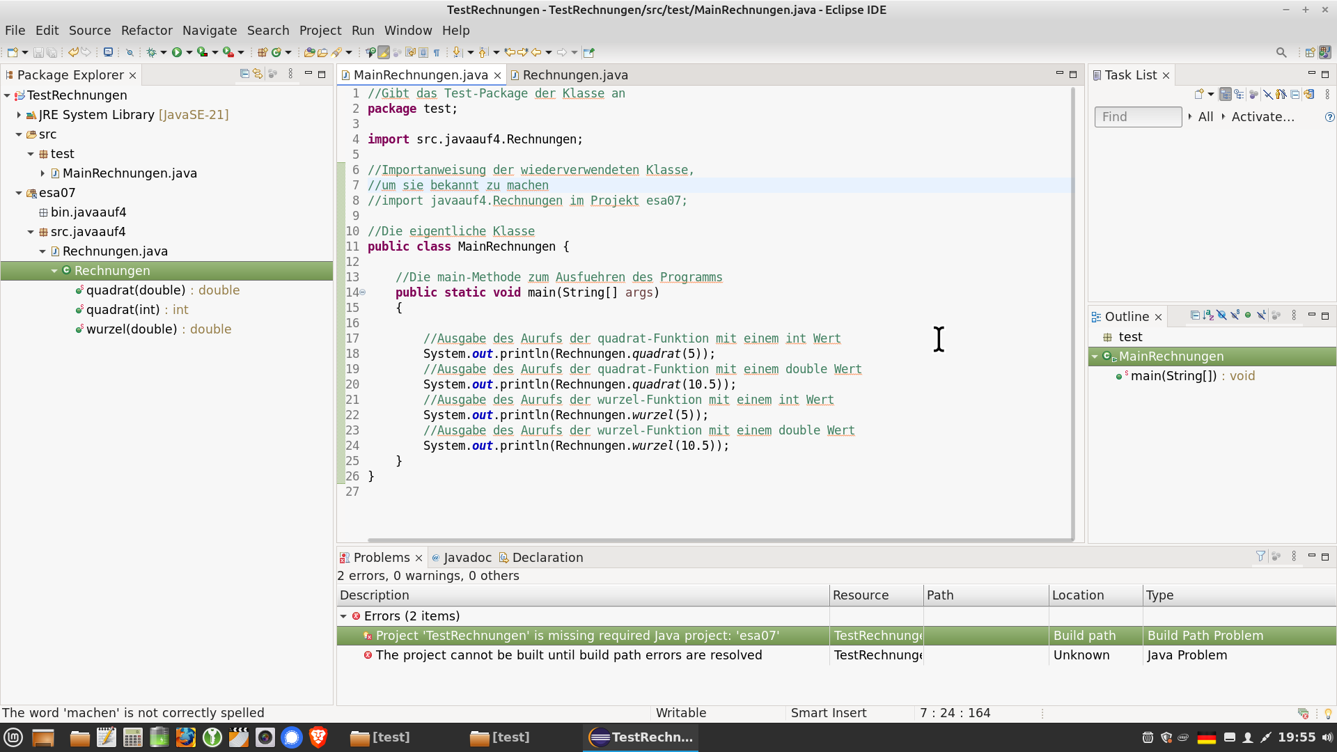

for a school project I do need to link 2 java-classes of different workspaces. It should work by:
1. right click on the the project (where the main class is)
2. choose "Build Path" , "Link Source..."
3. Browse for the other project on the other workspace and choose it
4. No Inclusion or Exclusion patterns
-> But there comes still the error that the other project was not found!?
See pictures attached
Does someone know a solution?

I have found the mistake! The reason was that one class should have the project layout with this option: "Use project folder as root for sources and class files"
and the other class with the main funktion within the other workspace should use "Create separate folders for sources and class files"
-> now it works good :)
