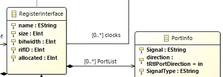

The classes in my ecore explorer (all of them, including "PortInfo") are not marked "interface" or "abstract".
The code below rases an editor error on "
P1=new PortInfo;
" saying "cannot instantiate the interface of type PortInfo"

I want the generator.xtend to collect information while generating and at some point add it to a list, that is a reference attribute in the class of the "RegIF" object.
If "PortInfo" is indeed an interface although NOT marked as such in the ecore, I believe I have to create an implementation for it. I did that in a separate xtend file

The overall question is: How do I make the PortInfo objects in the xtend code so I can add to RegIF.portList (in the same xtend code)
Alternatively, where and how do I add a PortInfo list to the RegIF class without editing generated files.
