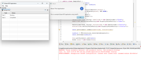

2. In my test application, I modify the SamplePart view to add a JavaFx table.
In these first tests, I did not enter the JavaFx SDK path in the ef(x)clipse plugin preferences.
First test:
I simply add the different JavaFx bundles of the target platform in the Required Plugins section.
Everything is OK there. The application launches fine, the JavaFx view is displayed and a JavaFx dialog box too.
No error, just a warning from JavaFx:
Jul 23, 2024 10:04:17 AM com.sun.javafx.application.PlatformImpl startup
WARNING: Unsupported JavaFX configuration: classes were loaded from 'unnamed module @75308740'
index.php/fa/44961/0/

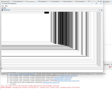

Second test: I complicate my application a little.
I add a class in which a UiSynchronize must be injected.
I want this UiSynchronize to be injected by: org.eclipse.fx.ui.di.interopt
	@Reference(service = UISynchronize.class, unbind = "-")
	private void setUISynchronize(UISynchronize uiSync) {
		this.uiSync = uiSync;
The application launches fine, view OK, dialog box OK.
On the other hand, the injection of the UiSynchronize reference fails. org.eclipse.fx.ui.di.interopt fails to activate
Caused by: java.lang.ClassNotFoundException: javafx.scene.Parent cannot be found by org.eclipse.fx.ui.di.interopt_3.9.0.202210170008
at org.eclipse.osgi.internal.loader.BundleLoader.generateException(BundleLoader.java:541)
at org.eclipse.osgi.internal.loader.BundleLoader.findClass0(BundleLoader.java:536)
at org.eclipse.osgi.internal.loader.BundleLoader.findClass(BundleLoader.java:416)
at org.eclipse.osgi.internal.loader.ModuleClassLoader.loadClass(ModuleClassLoader.java:168)
at java.base/java.lang.ClassLoader.loadClass(ClassLoader.java:525)
... 38 more
It seems to me that the problem is linked to the fact that the JavaFx libraries are not in the module-path.
I tested several arguments in the run configuration but without success.
In a second series of tests, I tried to run my application by entering the JavaFx 11 + SDK variable in the preferences,
but the result is even less good.
index.php/fa/44964/0/
