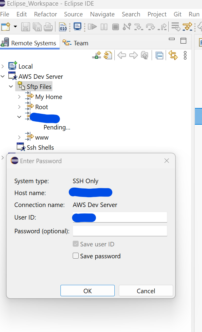

When I load Eclipse and select an SFTP folder on the remote server I get a UI as captured in attached image 1.
This is when I get the first error message as follows:
****Saved passwords are not available for migration to secure storage. Deprecated authorization classes (org.eclipse.core.runtime.compatibility.auth) are not installed.****
However this only relates to securely storing the password locally which I don't do.

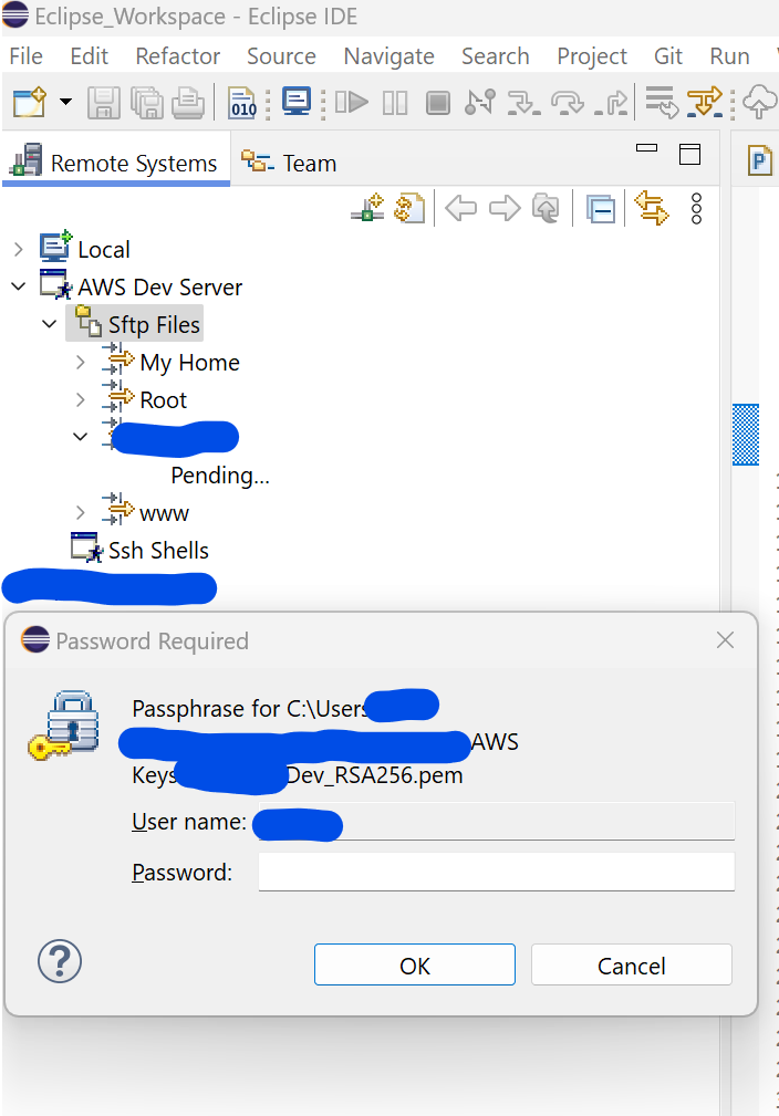

So, I enter my password and things move onto the next attached image 2, I'm presuming this first password is for my account on the server:
After I enter the auth key password in this second image I get the RSEG1066 error with this message:
****Failed to connect sshd on "<Server IP here>"****
****Auth Fail****
And the Error Log for this is empty with:
****An exception stack trace is not available.****
Log Session Data is:
