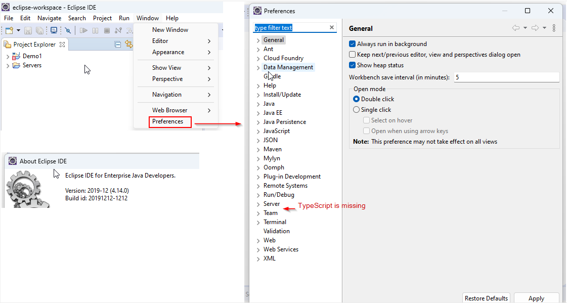

Hi all,
Please help me how to do add typescript in preferences in eclipse
i'm using Eclipse IDE for Enterprise Java Developers. ( inside windows 11)
Version: 2019-12 (4.14.0)
Build id: 20191212-1212
Thanh you very much!
  • Attachment: 6.png
    (Size: 57.52KB, Downloaded 93 times)
Re: How to do add TypeScript in Preferences [message #1866021 is a reply to message #1866018] Sat, 18 May 2024 00:52 Go to previous message
You can try installing the Wild Web Developer feature from https://archive.eclipse.org/releases/2019-12/201912181000/ , but the comment from
https://stackoverflow.com/questions/78493447/why-in-eclipse-ide-preferences-does-not-have-a-typescript-option is even more relevant here
in that that you would only have added limited support for an equally old version of TypeScript.
You need to upgrade to the current release.
