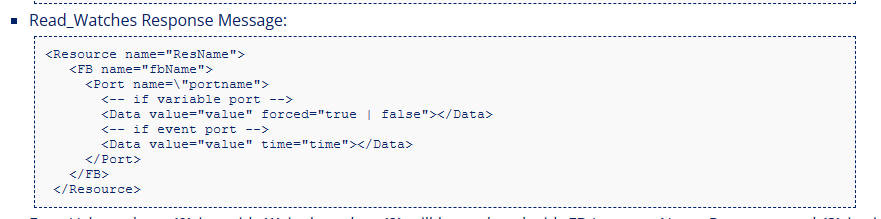

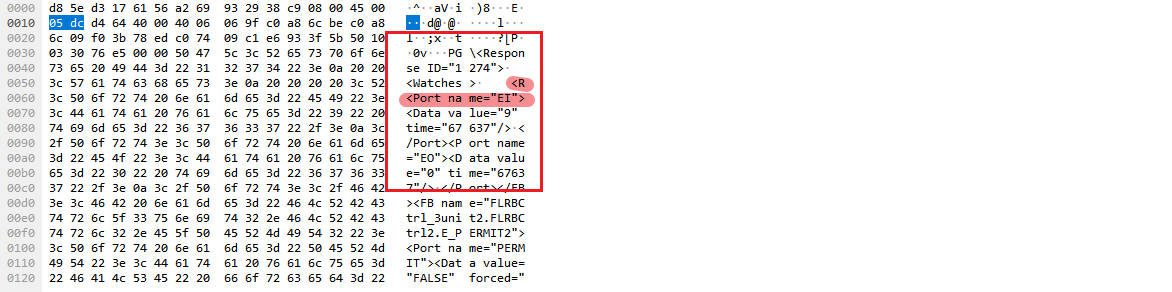

When I was using Wireshare to capture the response of Forte's monitor, I found that the monitor format of Forte's response was incorrect
Normal format is:
index.php/fa/44364/0/
But i receive the reponse message's format is:
index.php/fa/44367/0/
It seems that forte was assembled into the wrong format
The attachments are Wireshark capture file and .fboot file
