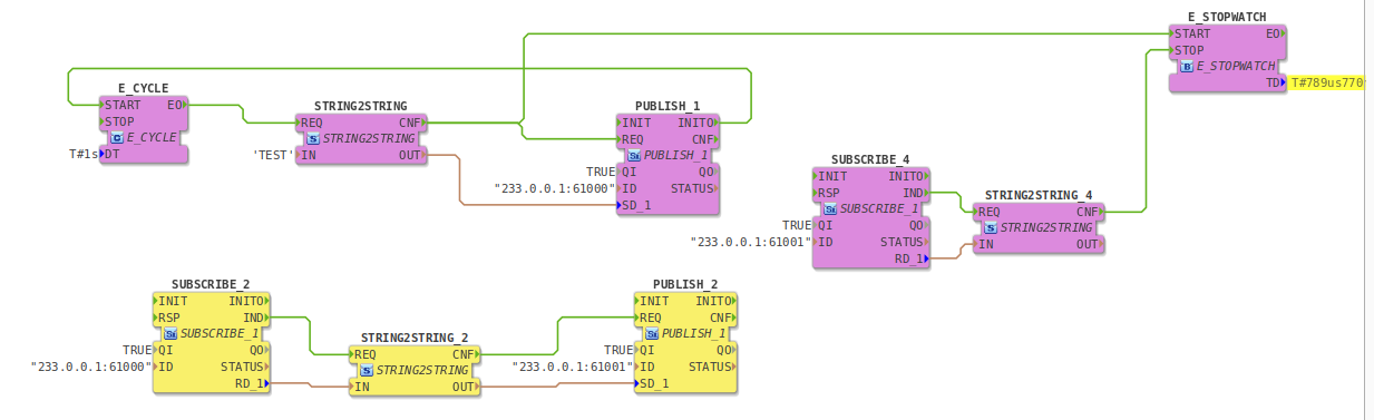

I am running some communication tests with FBDK and UDP so I get better understanding about its advantages and limitations. In order to doing so, I created a simple application (attached) so i can send data between a pc and a raspberry pi 4 over a local cabled network. (Ethernet segment)
So far I got around 50ms between sending and receiving the same data.
Is this the expected timing? Are there any configurations I may change in FORTE in order to achieve better times?

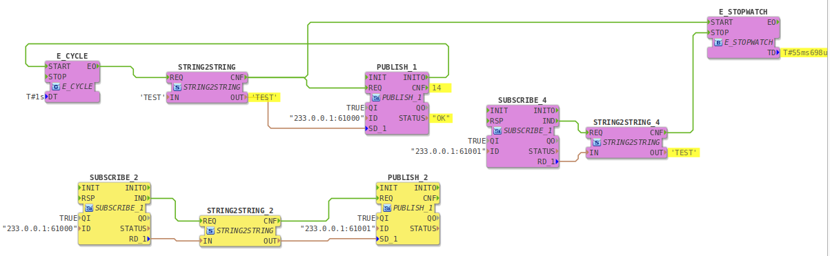

I made new tests on another network.
Times as low as 1ms (monitoring attached).
Certainly a network issue. Not 4diac.
Thanks in advance.
