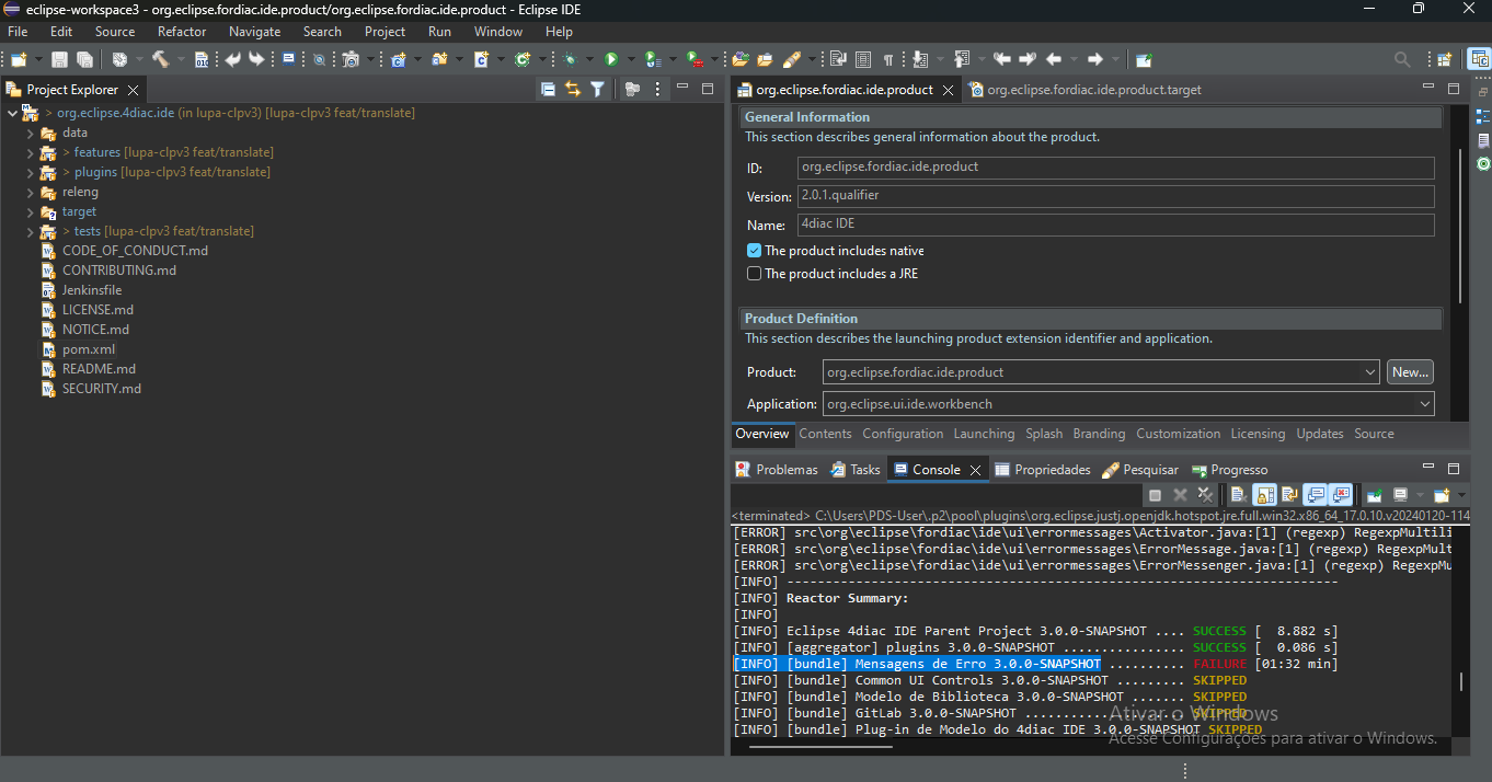

Hi, i tried to run maven in the 4Diac. But this error occurs. Someone can help? Thanks.
Re: Error with Maven [message #1865346 is a reply to message #1865343] Tue, 30 April 2024 15:00 Go to previous messageGo to next message

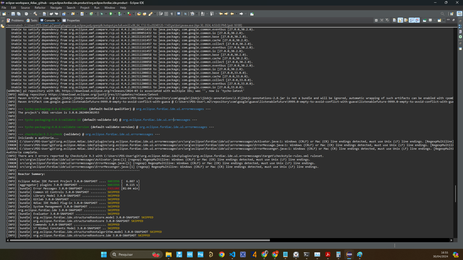

screenshots are unfortunately only partly helping. The full outputlog of the console would give more hints. This is just the summary where the problem occured but not why.
Re: Error with Maven [message #1865349 is a reply to message #1865346] Tue, 30 April 2024 15:55 Go to previous messageGo to next message
Follow the console errors.
Re: Error with Maven [message #1865376 is a reply to message #1865349] Wed, 01 May 2024 13:40 Go to previous message
It seems that during cloning the repo you haven't had the right settings. You need to ensure that during cloning you only get LF and not CR+LF
