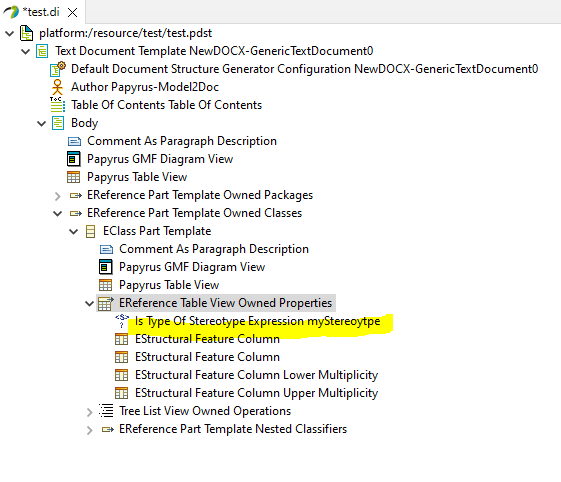

please could you attach an example of model with an exemple of the expected result to help us to understand your need.
I think you should be able to filter elements by their applied stereotypes with the Expression "IsTypeOfStereotypeExpression" like shown in the attached snapshot.
