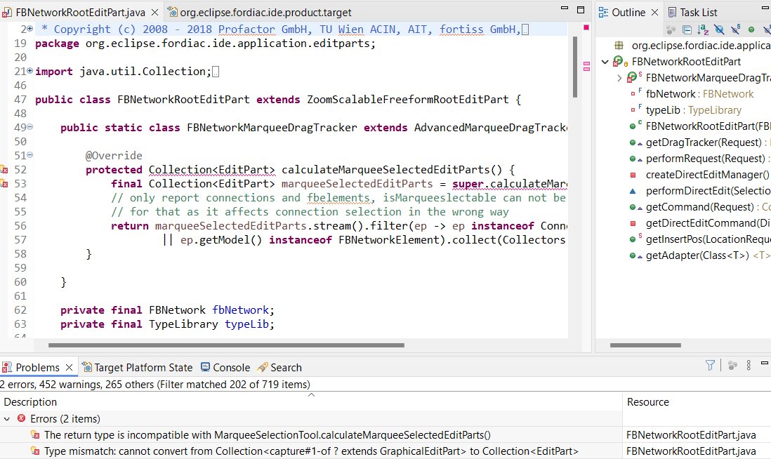

Hi, this error appeared when i try to bulild my project. I make the clone from develop.

You need to upgrade to latest Develop. There this problem is fixed.
A general recommendation, when you are using Develop is to regularly upgrade from origin.

Hello.
I have the same problem. I followed the guide and downloaded the 4diac source code from the link (git clone https://git.eclipse.org/r/4diac/org.eclipse.4diac.ide) and switch branch to develop (git checkout develop).
I also downloaded the source code of the 4diac develop version from the link: https://git.eclipse.org/c/4diac/org.eclipse.4diac.ide.git/commit/?h=develop
Re: Error in build 4Diac [message #1864992 is a reply to message #1864968] Mon, 22 April 2024 14:22 Go to previous message
as announced in several of our news channels our repositories are now on github. We have also an updated documentation on building 4diac IDE: https://github.com/eclipse-4diac/4diac-documentation/blob/main/src/development/building4diac.asciidoc
Feedback and improvements are appreciated.
Please note 4diac IDE development branch is on the migration to Java 21. So you need now also a Java 21 JDK.
