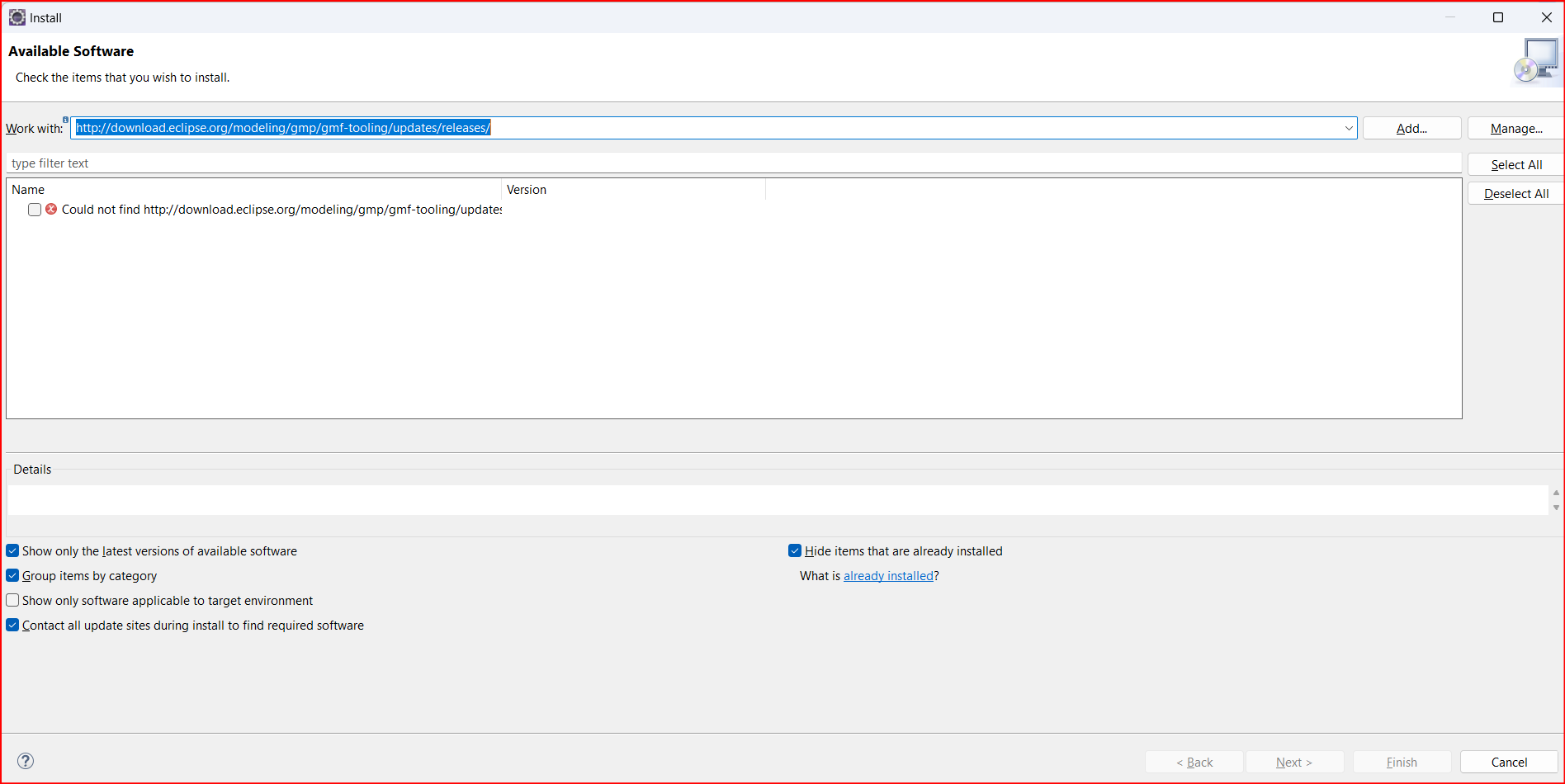

I used to download GMF tooling from this website: http://download.eclipse.org/modeling/gmp/gmf-tooling/updates/releases/.
But from 2 weeks back, this link is throwing 404. Hence I'm unable to install gmf tooling with the help of above link in Eclipse (Help -> Install new software -> site(http://download.eclipse.org/modeling/gmp/gmf-tooling/updates/releases/).

Re: GMF Tooling Issue [message #1864881 is a reply to message #1864878] Thu, 18 April 2024 03:21 Go to previous messageGo to next message
GMF Tooling is abandonned, and has been for a while.
The last release is from 2016 (https://projects.eclipse.org/projects/modeling.gmf-tooling), and the last commit on the git repo is from late 2015.
I have no idea where the corresponding update sites have gone.
Note that this concerns GMF **Tooling**; GMF Runtime itself is still maintained: https://projects.eclipse.org/projects/modeling.gmf-runtime/
