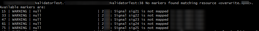

But when i try to run the tests on my maven/jenkins build it fails all the tests under validation, It seems it cannot identify the markers as they return null.
Any hint why should it be happening?
Thanks alot,
Leaving an example of the output of my maven run. (keep in mind that this happen with all the tests that require validation on the MyDSL.ui.tests)
index.php/fa/44145/0/
  • Attachment: test.png
    (Size: 29.31KB, Downloaded 160 times)

as discussed in chat
https://github.com/eclipse/xtext/pull/2907
you need to adapt your test
Re: Validation Test Fail after update to Xtext 2.34 and MWE 2.17 [message #1864872 is a reply to message #1864867] Tue, 16 April 2024 09:03 Go to previous message
Thanks to the help of Christian Dietrich, i was able to find the issue.
I had some miss usage of getAtribute in some util class that was using Imarker.LOCATION.
This was leading to retrieve a null value instead of the right marker.
