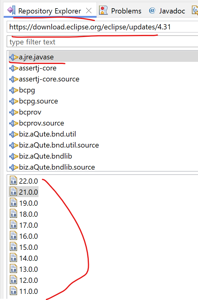

The statement that "this capability is not available in the current OSGi environment" is not correct. The runtime synthesizes the profile details from the running environment.
Most likely the failure you see is one from p2 and for that case, the installation relies on the a.jre.javase IUs available in some p2 repository.
index.php/fa/44138/0/
The Tycho build can generates just IUs into the repository. I forget the details...
