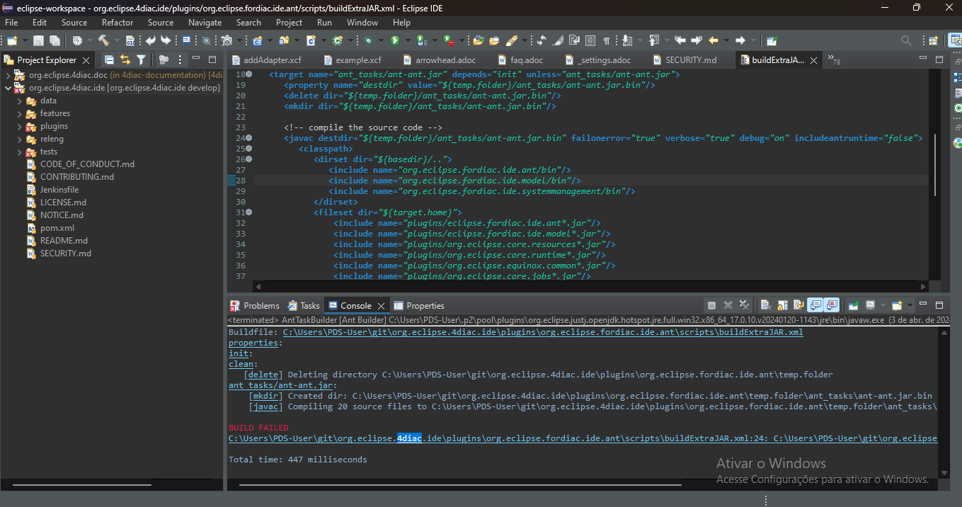

Re: How to build and run the 4DIAC IDE from source [message #1864691 is a reply to message #1864666] Wed, 03 April 2024 09:24 Go to previous messageGo to next message
Hello Alois, i made the changes and i have these errors. Do you know what i need to do?
[Updated on: Wed, 03 April 2024 10:45] by Moderator
Re: How to build and run the 4DIAC IDE from source [message #1864693 is a reply to message #1864691] Wed, 03 April 2024 11:02 Go to previous messageGo to next message
I haven't tried building the master branch for a long time. Master is the latest release. If you want to work from source I strongly recommend to use develop or freeze branch.

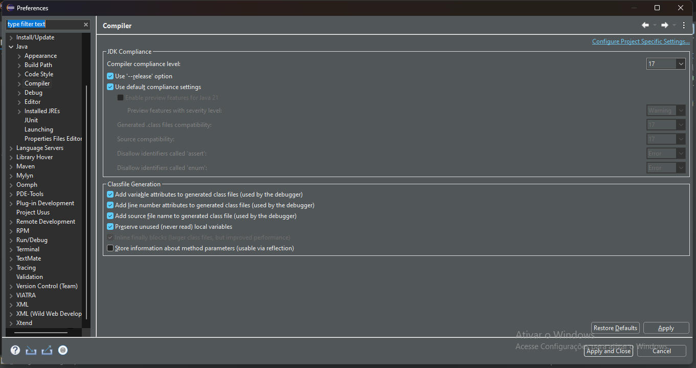

Re: How to build and run the 4DIAC IDE from source [message #1864696 is a reply to message #1864695] Wed, 03 April 2024 12:05 Go to previous messageGo to next message
What Java compiler level is set in your preferences: Window -> Preferences -> Java -> compiler. Currently it needs to be Java 17
Re: How to build and run the 4DIAC IDE from source [message #1864697 is a reply to message #1864693] Wed, 03 April 2024 12:11 Go to previous messageGo to next message
I read the documentation and made the checkout to develop. And i have the same problems.
Re: How to build and run the 4DIAC IDE from source [message #1864698 is a reply to message #1864696] Wed, 03 April 2024 13:34 Go to previous messageGo to next message
Yes it's.

Re: How to build and run the 4DIAC IDE from source [message #1864712 is a reply to message #1864701] Thu, 04 April 2024 07:48 Go to previous messageGo to next message

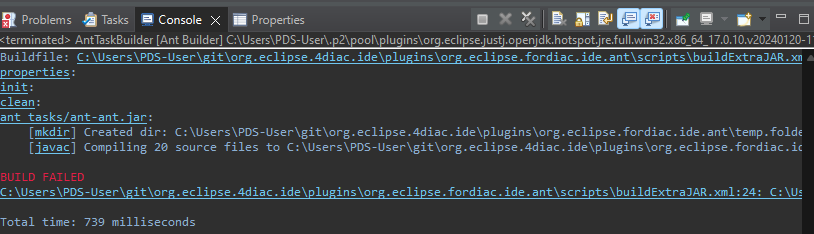

The error message from the ant task in the console can be ignored. Can you show the other error messages. I guess a full clean rebuild could help.

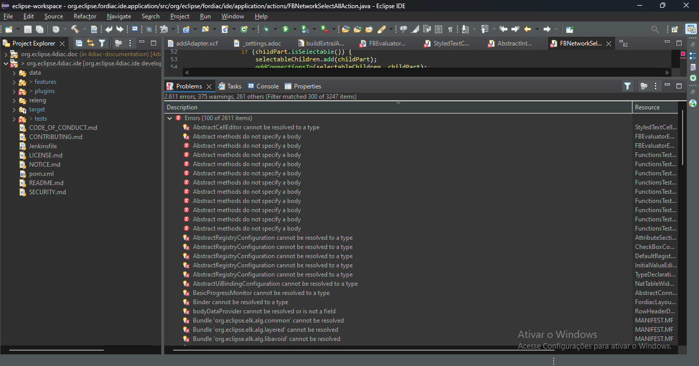

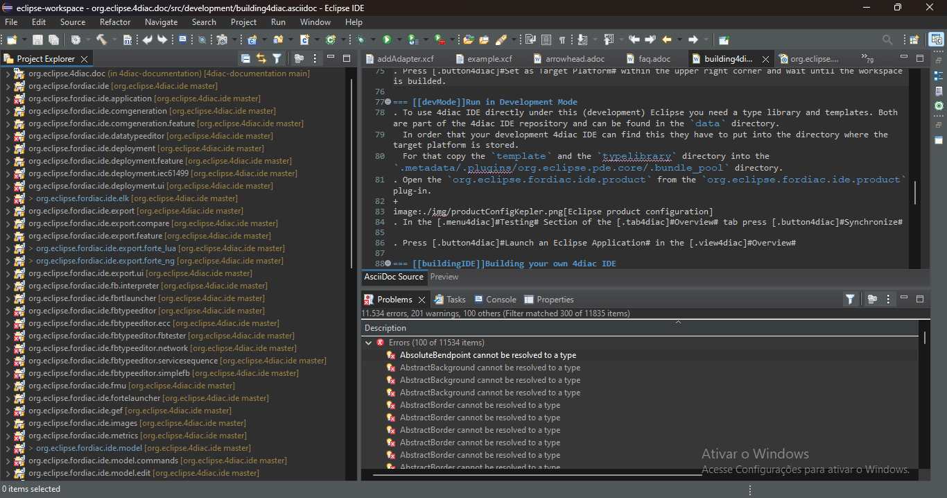

Re: How to build and run the 4DIAC IDE from source [message #1864716 is a reply to message #1864712] Thu, 04 April 2024 10:12 Go to previous messageGo to next message
This is the errors.
Re: How to build and run the 4DIAC IDE from source [message #1864718 is a reply to message #1864716] Thu, 04 April 2024 10:49 Go to previous messageGo to next message
It feels like the target platform is not correctly loaded.
Re: How to build and run the 4DIAC IDE from source [message #1864720 is a reply to message #1864718] Thu, 04 April 2024 12:22 Go to previous messageGo to next message
How can i select the target?

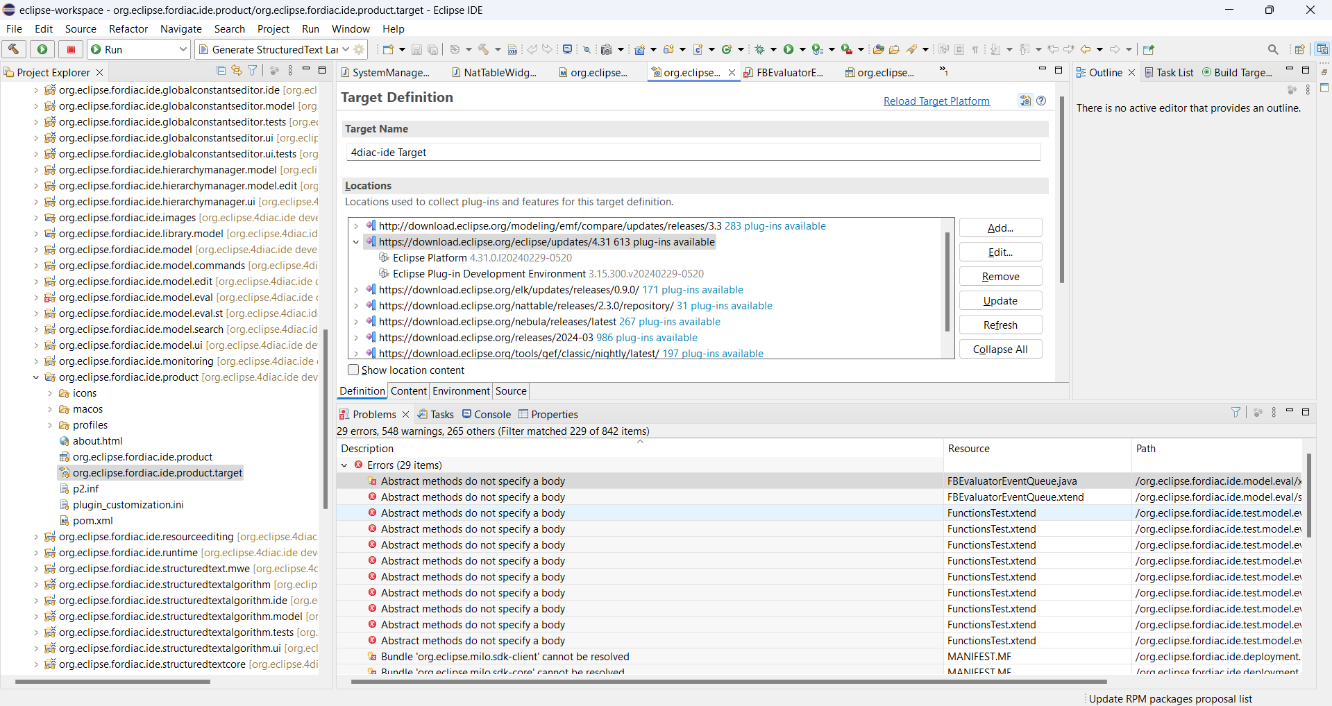

Re: How to build and run the 4DIAC IDE from source [message #1864721 is a reply to message #1864720] Thu, 04 April 2024 12:32 Go to previous messageGo to next message
as described in the documentation: open the target platform file from the org.eclipse.4diac.ide.product plugin, IMPORTANT: wait till the target platform is full loaded (look for progressbar at the bottom right), when the target plattform is loaded, on the top right select set as active target platform. This should lead to a full rebuild of 4diac ide.

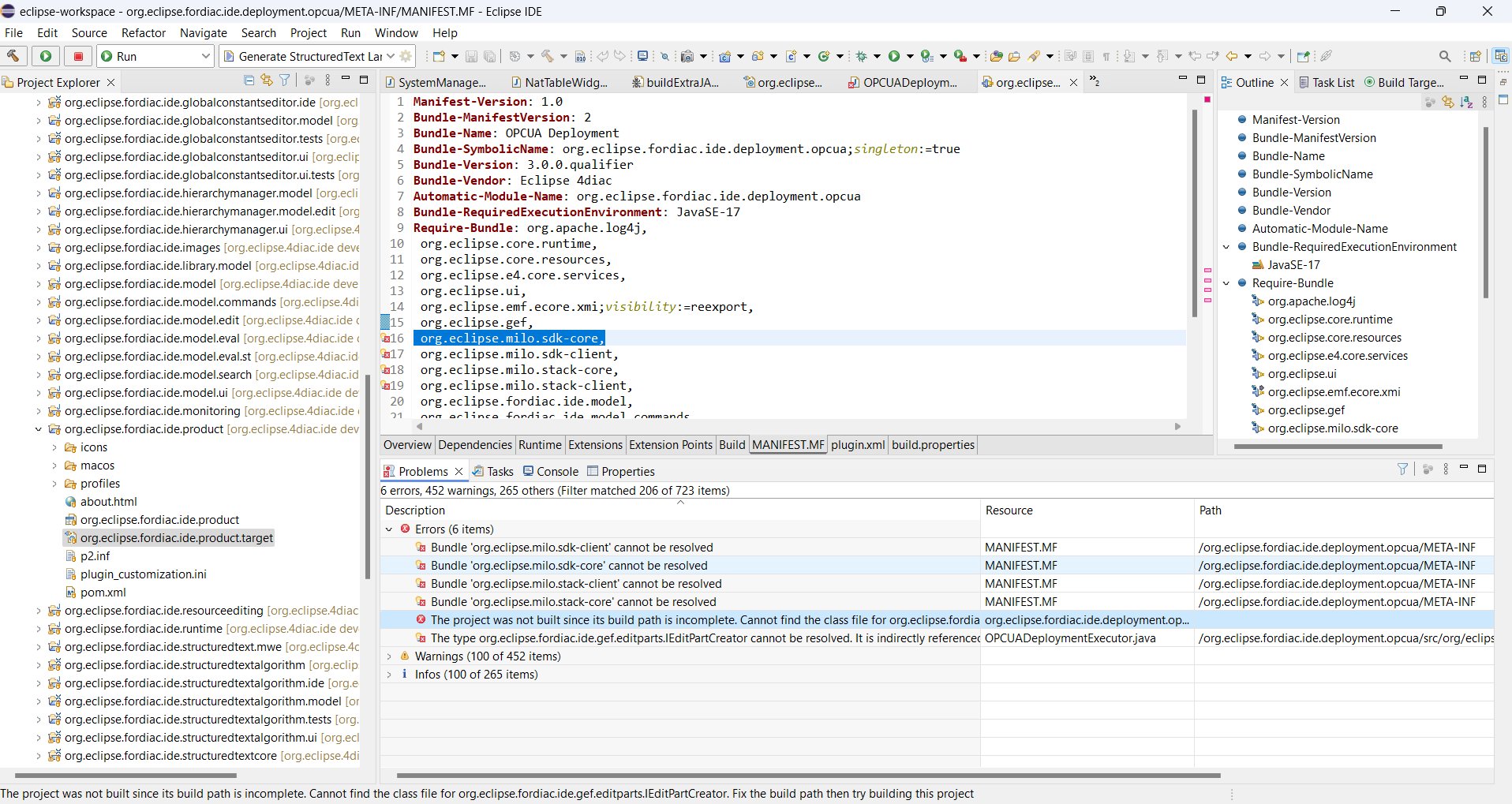

Re: How to build and run the 4DIAC IDE from source [message #1864730 is a reply to message #1864721] Fri, 05 April 2024 07:00 Go to previous messageGo to next message
Hello, I made the changes you mentioned and the amount of error decreased a lot. These still remained here. Is there anything else I need to adjust?
Re: How to build and run the 4DIAC IDE from source [message #1864731 is a reply to message #1864730] Fri, 05 April 2024 07:05 Go to previous messageGo to next message
I just merged the above mentioned PR regarding building 4diac IDE from source. From the error messages I think you are missing the m2e PE support feature and for the errors on xtend files I think simply cleaning and recompiling these plugins should help.

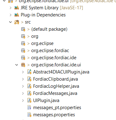

One more question Alois, it's possible to change the language of 4Diac? My customer want to change the language to portuguese and use 4Diac as logic development software.
Re: How to build and run the 4DIAC IDE from source [message #1864733 is a reply to message #1864732] Fri, 05 April 2024 07:37 Go to previous messageGo to next message
Yes it is. Or lets phrase it better, we started to prepare for translations. In most of the plugins you will see message.property files. These files contain the texts that needs to be translated. By providing message_pt.properties files with the translated messages text should be in portuguese. but I guess we would need your support to do it everywhere. More information on this topic can be found in this article: https://www.eclipse.org/articles/Article-Internationalization/how2I18n.html

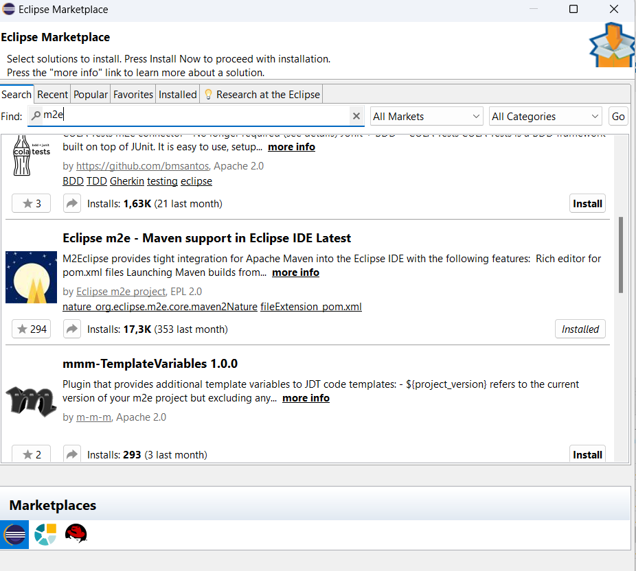

Alois, the m2e is installed and i change the compiller to 22. Now i returned to 17 and the errors decreased to 6. Do you have some tip about these errors? Thanks for the help.

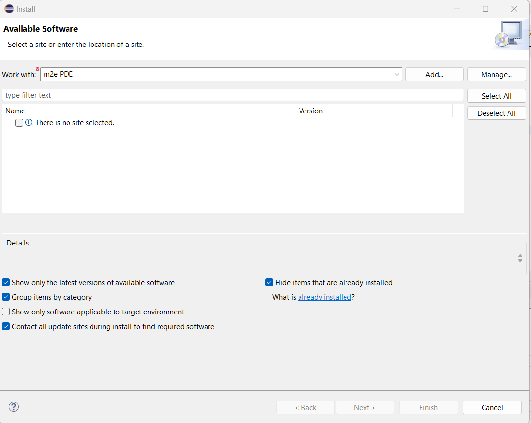

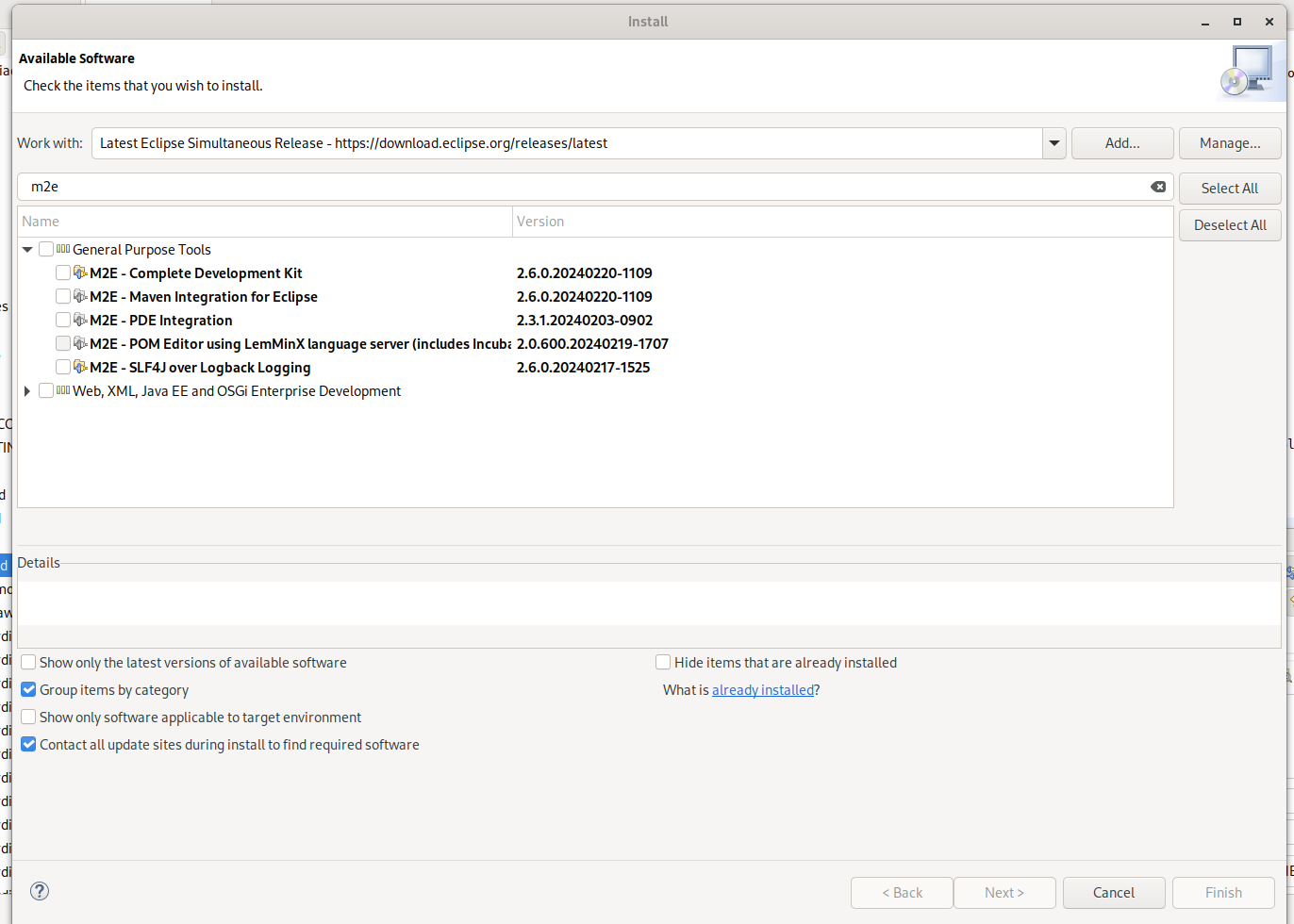

Re: How to build and run the 4DIAC IDE from source [message #1864737 is a reply to message #1864736] Fri, 05 April 2024 08:30 Go to previous messageGo to next message
m2e is not enough you need to go to install new software, select your eclipse release and search for "m2e PDE ..." the PDE is important as written in the documentation.
Re: How to build and run the 4DIAC IDE from source [message #1864740 is a reply to message #1864737] Fri, 05 April 2024 09:12 Go to previous messageGo to next message
That's show to me.
Re: How to build and run the 4DIAC IDE from source [message #1864741 is a reply to message #1864740] Fri, 05 April 2024 09:17 Go to previous messageGo to next message
in that line you need to select the update site. It look like:
Re: How to build and run the 4DIAC IDE from source [message #1864742 is a reply to message #1864741] Fri, 05 April 2024 09:57 Go to previous messageGo to next message
Great Alois, build and run. Thanks for the help.

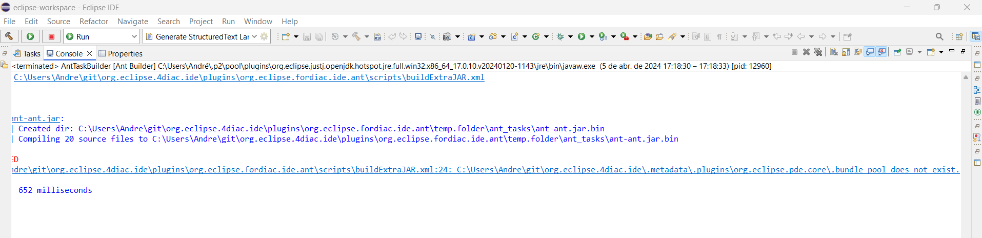

Re: How to build and run the 4DIAC IDE from source [message #1864753 is a reply to message #1864752] Fri, 05 April 2024 16:24 Go to previous messageGo to next message
The console shows this message to me. And in my workspace the .metadata dont exist.
[Updated on: Fri, 05 April 2024 16:27] by Moderator
Re: How to build and run the 4DIAC IDE from source [message #1864754 is a reply to message #1864753] Fri, 05 April 2024 17:26 Go to previous messageGo to next message
As written above. This message can be ignored. This ant task is needed for building the final 4diac IDE on the build server. However I never managed to get it working on old developer's machines.

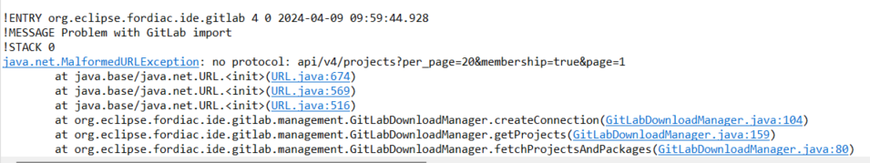

Re: How to build and run the 4DIAC IDE from source [message #1864780 is a reply to message #1864754] Tue, 09 April 2024 09:03 Go to previous messageGo to next message
Hi, i get the templates and the typelibrary correct. But after that i get this error:
!ENTRY org.eclipse.fordiac.ide.gitlab 4 0 2024-04-09 09:59:44.928
!MESSAGE Problem with GitLab import
!STACK 0
Re: How to build and run the 4DIAC IDE from source [message #1864803 is a reply to message #1864780] Wed, 10 April 2024 05:18 Go to previous messageGo to next message
That's an error on my part - the IDE tries to download missing libraries from a configured GitLab
Will change this to fail silently / not attempt it if no server is configured

Hi Alois, i create the message_pt.properties but i dont know how to define this file to translate the text. I need to do some configuration?
