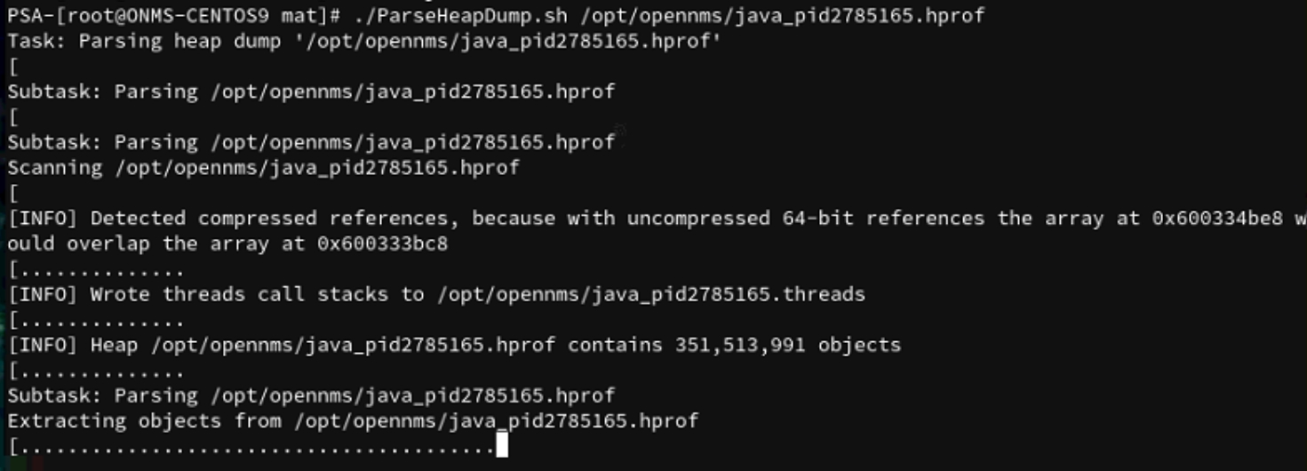

In the MAT-EXEC.jpg there is the start of execution of MAT.
The problem is that the MAT is running but it seems "freezed" because the log files it is creating are not updated anymore ...more than seven hours without modification (that files are all still in use (fuser) by the MAT tool)

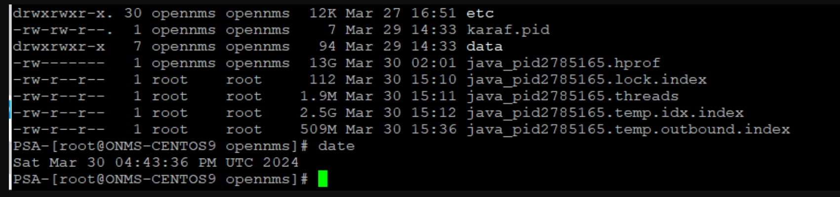

In the MAT-FILES.jpg there are the list of files used and created by MAT

Update: after about 20 hours the situation is not changed ..are the 351M objects that MAT must extract the cause of this ?
Re: MAT 1.15.0.20231206-linux - seems blocked [message #1864636 is a reply to message #1864635] Sun, 31 March 2024 13:53 Go to previous message
UPDATE 2 After one day, nothing is changed, I have stopped MAT.
