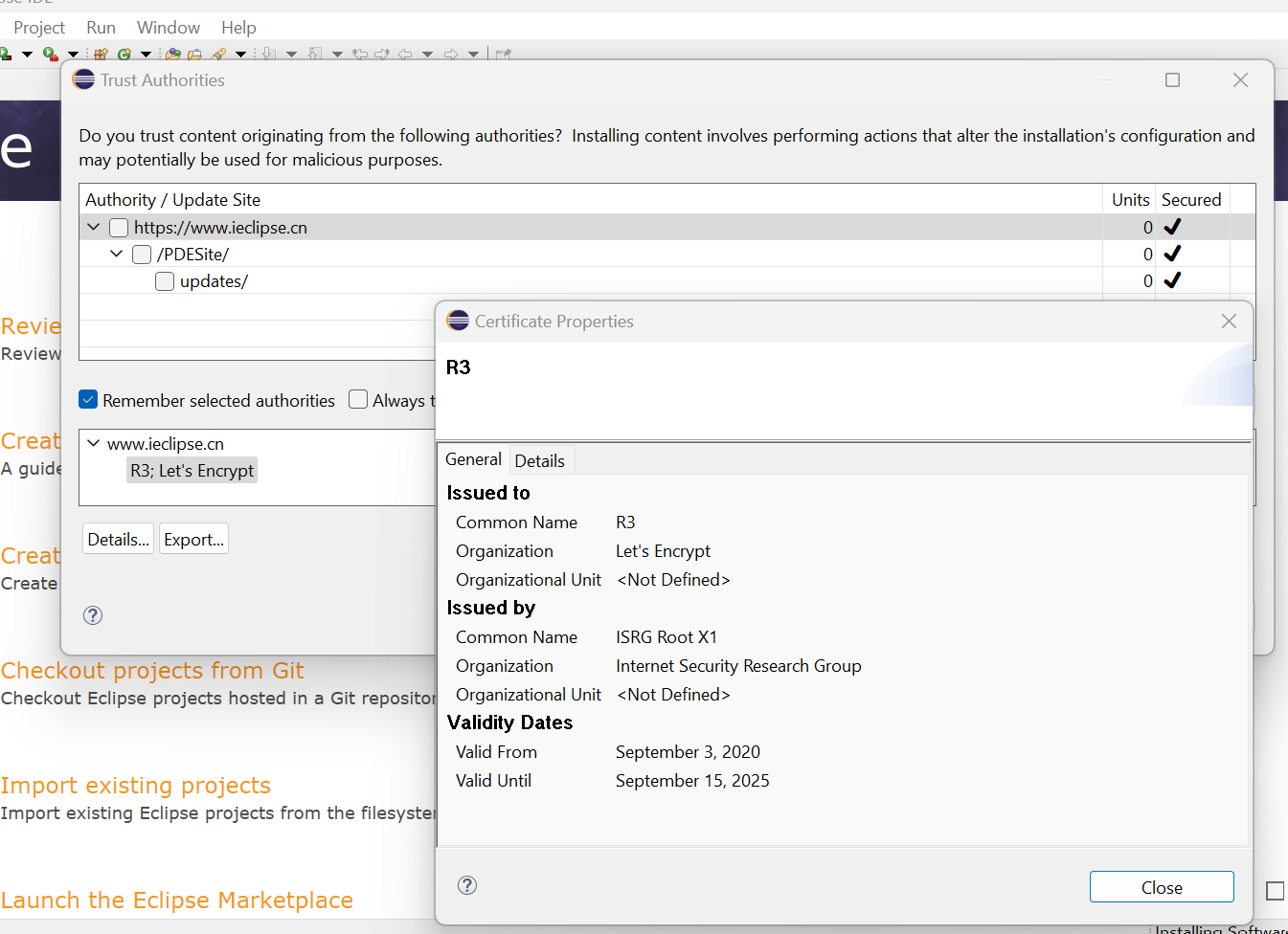

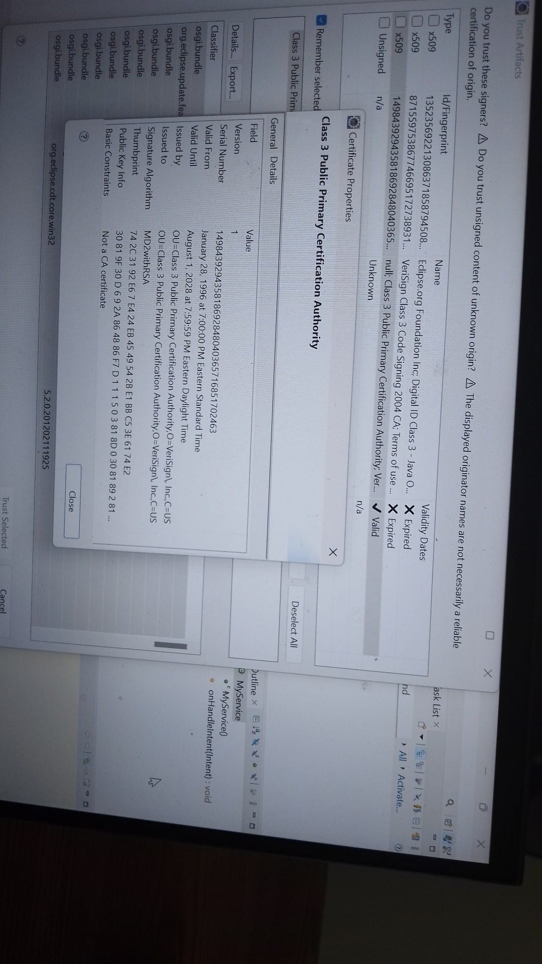

I just downloaded and installed Eclipse IDE for Ent Java and Web.
Click on Help, then Marketplace. Search for android. The second result from the top. Install Android Development Tools.
Then I'm being asked to trust a cert without a cn and the signing algo md2withRSA. Who here is trusting md2?
See screenshot.
Now, if I try the same in Eclipse 2023-06, the cert is different. From Let's Encrypt. But also it displays that update authority is ieclipse.cn - Chinese tld domain...
Is this ieclipse.cn trustworthy source or no so?...

You've mostly covered the content associated with that certificate. But I see one bundle there that appears to be from 2012. Such old bundles will often have signatures using a certificate where the root of that certificate is no longer present in cacerts of the JDK used by the installation, hence the dialog comes up. They often use weaker algorithms. And these days, some JDKs consider some signatures so weak, they they ignore them and treat the jar as unsigned.
The other picture shows information about the host from which you are downloading the content and the certificate there is the certificate used for https traffic via that host. That's a totally different certificate than one that might be used to sign content.
I cannot decide for you what you should trust. Even if everything is signed properly, that doesn't mean can't "do bad thing."

Re: signing certificate for tools from marketplace [message #1864509 is a reply to message #1864507] Wed, 20 March 2024 12:05 Go to previous messageGo to next message
One dialog is for Trust Authorities and the other for Trust Artifacts, so one show you URLs for web sites from which content is being fetched, and you can inspect the certificate used for the https connection (just as you can do in a browser). The other dialog shows you signature information about the jar signatures (certificate-based), PGP signatures, or lack there of (unsigned). So it's apples and oranges.

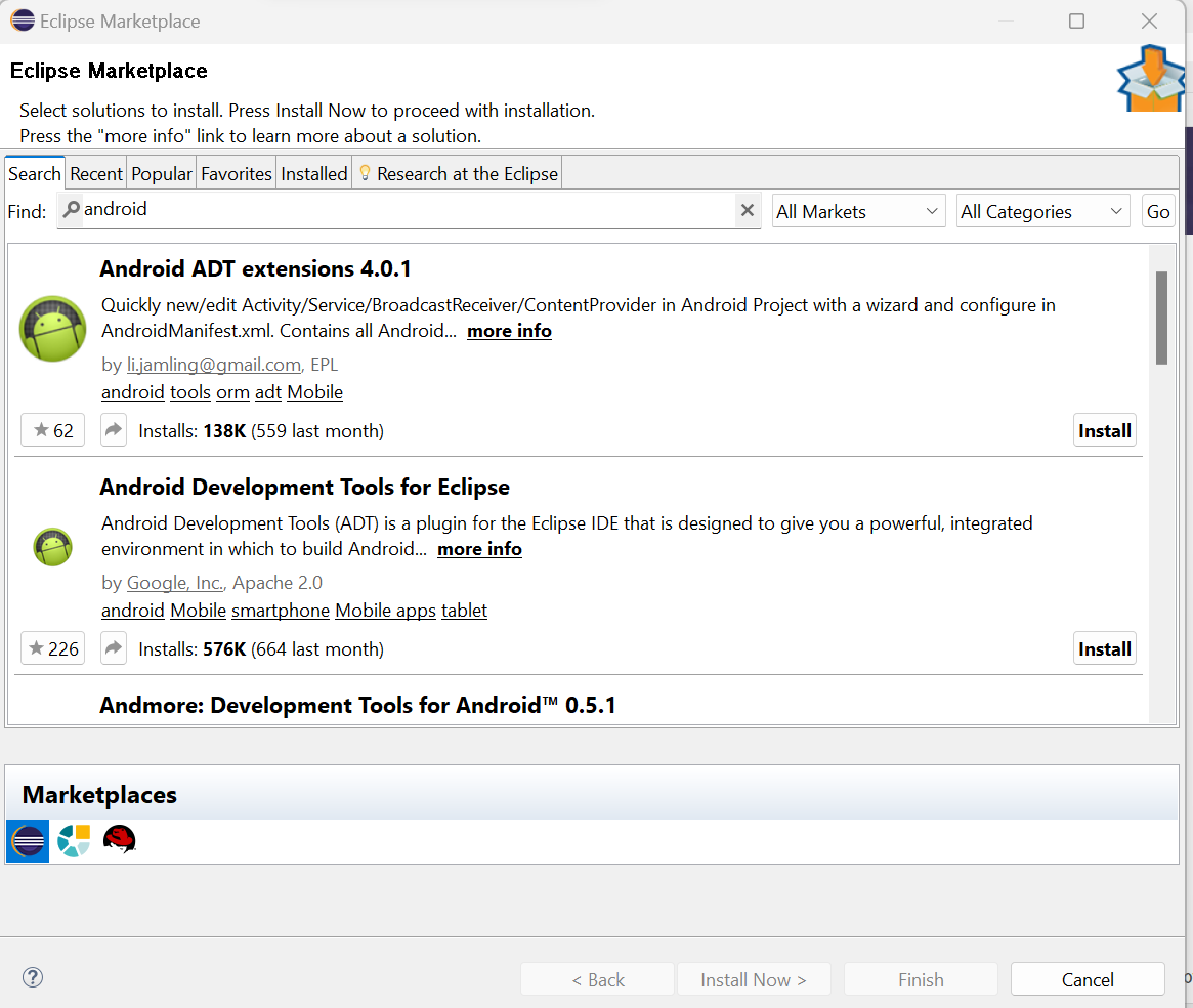

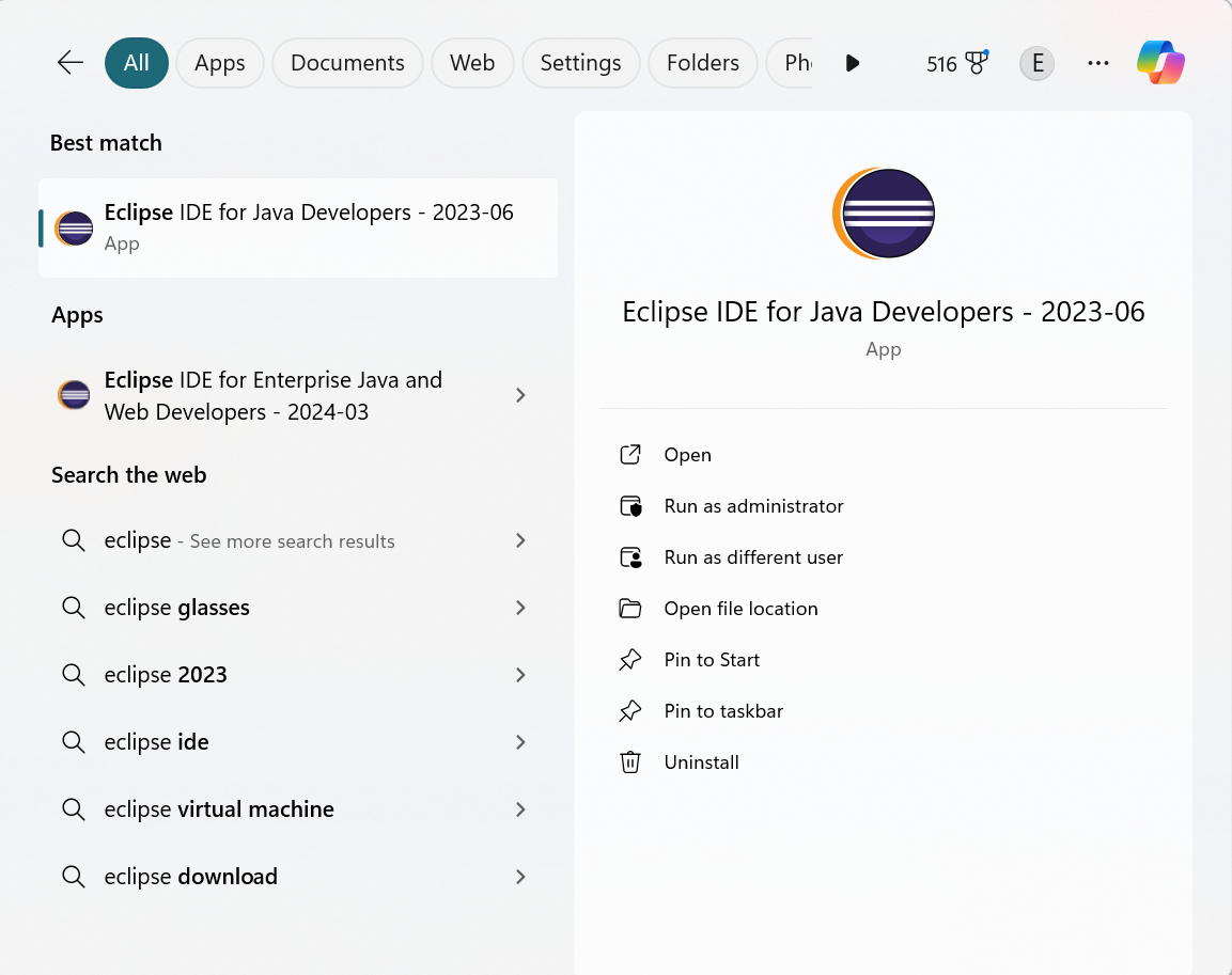

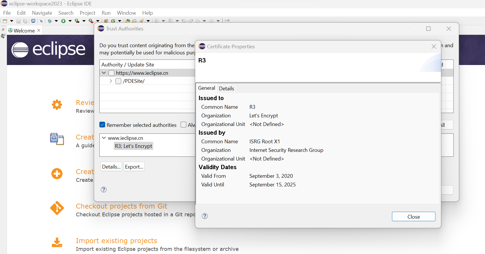

Re: signing certificate for tools from marketplace [message #1864525 is a reply to message #1864524] Thu, 21 March 2024 10:55 Go to previous messageGo to next message
index.php/fa/44080/0/Ed,
thanks for responding.
I{m attaching 4 screenshots.
The first one shows that I have 2 different versions of Eclipse installed.
I did try installing this adt thing using both versions of Eclipse.
So, on second screenshot I {m in 2023'06 version of Eclipse.
I clicked Help and then Marketplace. etc.
If repeat these steps for the Eclipse 2024 (see the first screenshot), then I get a binary signed with md2/rsa. with md2/rsa a binary may be laced with crap.

Re: signing certificate for tools from marketplace [message #1864527 is a reply to message #1864525] Thu, 21 March 2024 12:41 Go to previous messageGo to next message
Yes, picture 3 shows https://marketplace.eclipse.org/content/android-adt-extensions at the top of the list. That use the site in shown in the Trust Authorities dialog. I doubt you are repeating the steps exactly but rather are choosing different things to install.
