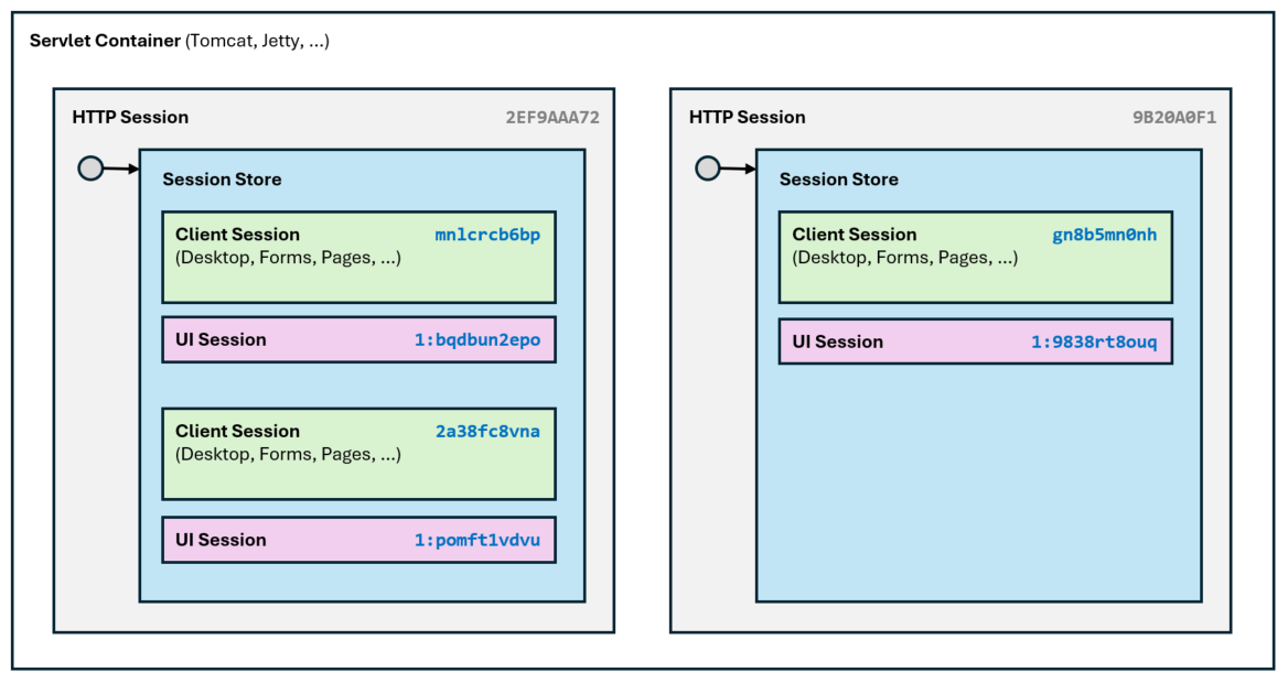

In a classic Scout applications you will find 3 types of "sessions":
  1. The HTTP session (HttpSession) is created and managed by the servlet container. The application can access the HTTP session through the standard J2EE API. It represents a "state" on the server. Its unique ID is stored in the cookie JSESSIONID and is sent along every subsequent HTTP request by the browser. This allows the container to match a (usually stateless) HTTP call with the existing HTTP session.
  2. The client session (ISession) is a Scout-specific object that consists of the application model. It contains all outlines, pages, forms, fields etc.
  3. The UI session (IUiSession ) connects the current browser window with a client session. It sends events from the model to the browser and vice-versa. It does not have a state of its own.
If you open a Scout application twice in two tabs in the same browser, they will share the same HTTP session (because cookies are shared between all tabs), but have two different client sessions (because the clientSessionId is stored the browser's "session storage", which is not shared between tabs). When you reload one of the tabs, the same client session will be re-used, but a new UI session will be created. If you open the application in two different browsers, you will have two different HTTP sessions, because the JSESSION cookie is not shared between browsers.
The scout sessions (client session, UI session) are stored in a "Session Store" object that itself is stored in a HTTP session attribute. This ensures that even if two different users were to request the same client session ID, they would not receive the same client session, because they can't see each other's session store.
index.php/fa/44078/0/
The situation you describe would only be possible if both users used the same HTTP session. Under normal circumstances this is impossible, because a new HTTP session is always created after a successful login (see FormBasedAccessController.handleAuthRequest). After that, the mapping from the JSESSIONID cookie to the HttpSession is done automatically by the container, before Scout is even involved. Did you check your Tomcat configuration? The default configuration should be fine, but if you have special settings or "login modules" installed, something might not work as expected. If you use your own AccessController implementation, please also carefully examine your code for any potential session mixups.
