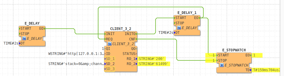

4. Using the FB E_STOPWATCH in order to measure the time between an REQ and CNF event for a get requisition (on a local server) the average time for a response is around 150ms. I suspect this is a long time and probably I am doing something wrong. However I am just using one FB_CLIENT_3_2 and nothing more.
I am sending a picture of my test application.
Thanks in advance!
