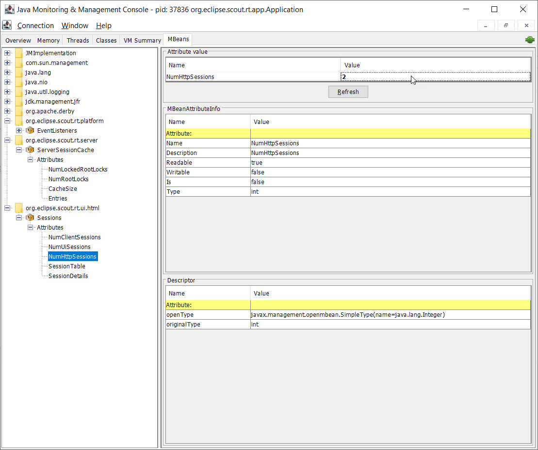

just for the sake of completeness, Scout offers further monitoring possibilities:
MBeans
There are some @MXBean available providing information about the number of sessions (http, ui, client server) and a few other metrics.
You can use jconsole, that is included in the JDK, to show that information.
index.php/fa/43998/0/

  • Attachment: jconsole.png
    (Size: 53.07KB, Downloaded 286 times)
