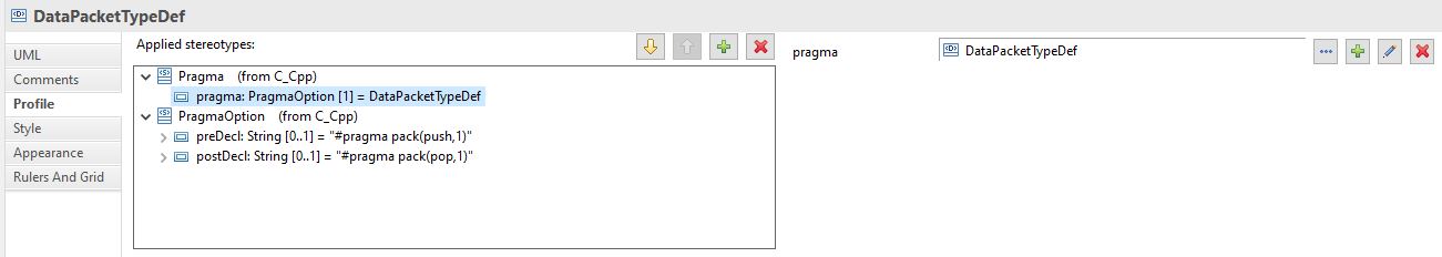

I try to create C++ code from the UML diagram.
For DataType, I want to add a pragma before and after the declaration.
In DataType stereotypes I added PragmaOption and Pragma.
For Pragma Option I set preDecl and postDecl to some pragmas that I want to use, however generated code uses preDecl value for postDecl.
Example:
preDecl = #pragma pack(push,1)
postDecl = #pragma pack(pop, 1)
Generated code uses #pragma pack(push,1) for postDecl.
struct DataPacketTypeDef {
     int a;
     char *b;
index.php/fa/43966/0/

this is a bug, unnoticed since some time, as we don ´t use the pragma feature internally. I've created issue https://gitlab.eclipse.org/eclipse/papyrus/org.eclipse.papyrus-designer/-/issues/4
(as SW designer moved to gitlab, this is now a gitlab issue and no longer done via bugzilla)
It is hopefully fixed (in nighly build tomorrow)
