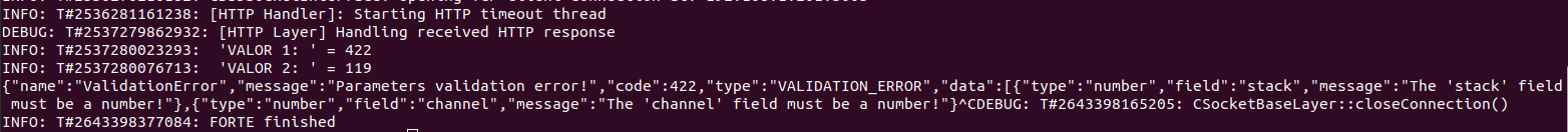

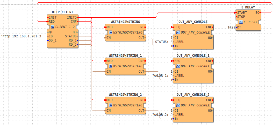

Hi! I have a test application where i send a GET request over HTTP with two parameters of type integer. I am able to successfully connect to the server but i got a validation error asking for a type "number".
Below is the string for the ID in FB, where stack=0 and channel=2 are the parameters.
"http[<IP:PORT>/<PATH>?stack=0&channel=2;GET;application/json;*]".
Is there a way I may force the type of parameters inside the string? Or any workaround on the client side?
The application and the forte debugging are in the attachments.
