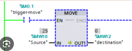

index.php/fa/43900/0/
Hello Alois, its like the command MOVE of a PLC. In the image there's an example.
Re: Variable Movers (assignment) [message #1862987 is a reply to message #1862983] Wed, 10 January 2024 02:50 Go to previous messageGo to next message
I know what the move block does. I don't think you need a move block in IEC 61499. In IEC 61499 FBs are sampling their inputs based on input events. Therefore you have a good control over when variables are copied. Using a move block would most probably be just a waste of CPU resources and memory. Therefore I wanted to ask what you want to do with it.
However I checked and our IEC 61131-3 library has an implementation of the MOVE function.
In general all FBs and Functions defined in the IEC 61131-3 standard are available in Eclipse 4diac. Please search in the IEC 61131-3 lib folder. All IEC 61131-3 functions are also available for writing ST Algorithms when developing your own FBs.

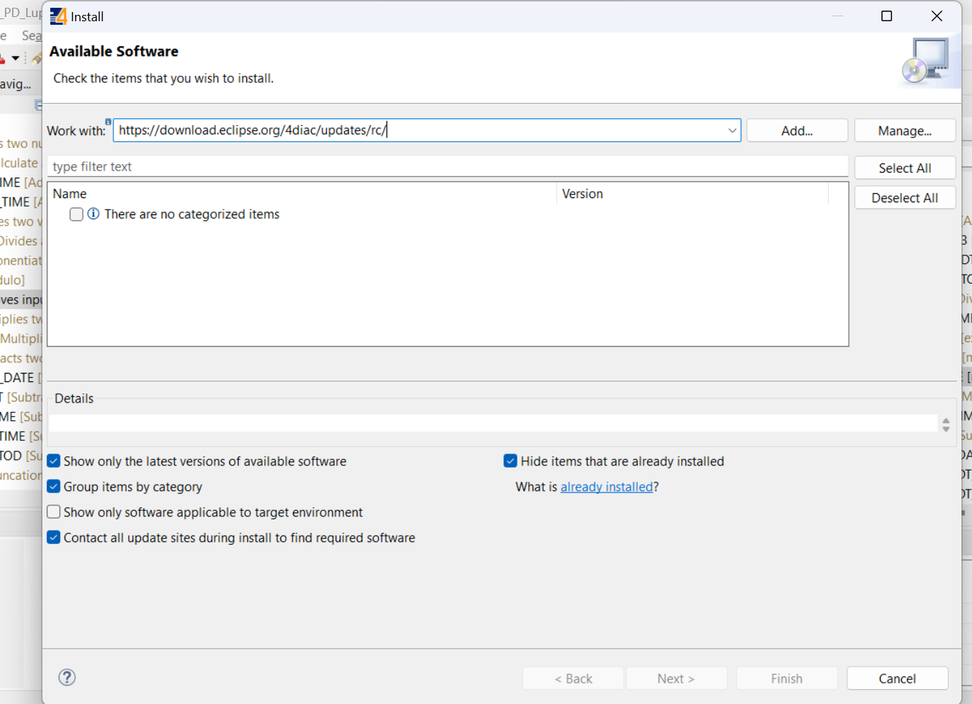

index.php/fa/43902/0/
Nothing to download appeared in my version in the software installation tab.
Re: Variable Movers (assignment) [message #1863016 is a reply to message #1863015] Wed, 10 January 2024 17:23 Go to previous message
The new version is too different therefore upgrading in that we is unfortunately not working. You need to download the full package for your OS which you can also find at that location. From then on automatic updates work.
