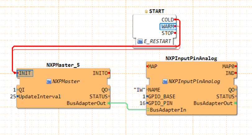

Hi, I'm working on developing the analog block for NXP. I would like to know how I can find out the name of a block, for example, called NXPInputAnalogPin. I'm debugging on my computer and I even got to the image code. If I can find out the name of the block, I can choose whether I want to trigger an analog block or just a digital output. Is it possible to get the name of the block?
  • Attachment: Blocks.png
    (Size: 93.20KB, Downloaded 72 times)
Re: Discover the name of a block [message #1862959 is a reply to message #1862904] Mon, 08 January 2024 14:08 Go to previous messageGo to next message
The class CFunctionBlock has a getInstanceName() method. Is this what you are searching for?
Re: Discover the name of a block [message #1862961 is a reply to message #1862959] Mon, 08 January 2024 14:59 Go to previous message
Thanks Alois, that's it.
