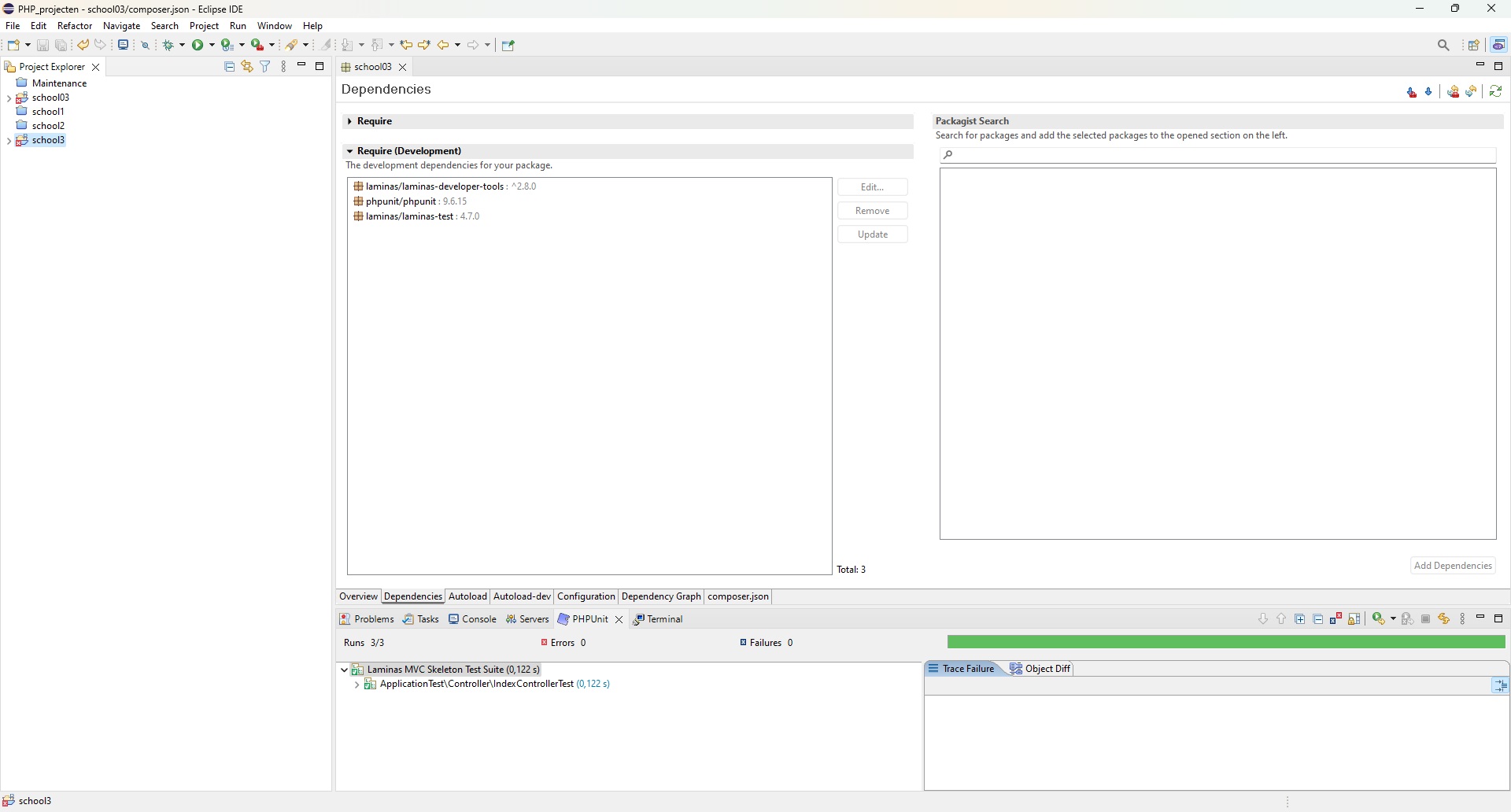

By coincidence i discovered that the name of the project causes the problem! School3 is not working (and gives the error while testing), school03 does work! So the project name has to be 8 characters long at least with Laminas and PHP unit (I assume after testing)
  • Attachment: phpunit.jpg
    (Size: 188.44KB, Downloaded 90 times)
