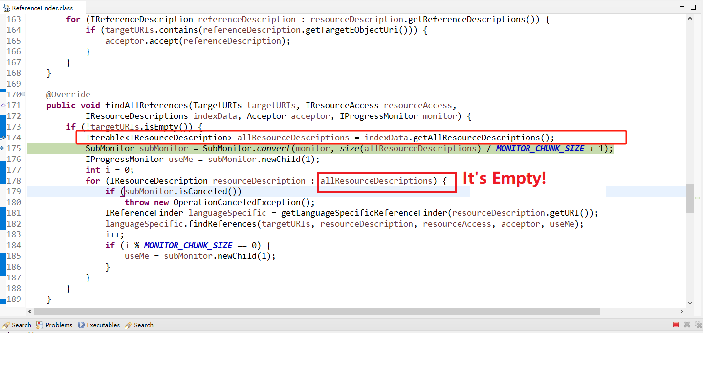

I created two DSLS with xtext, one called DSL A and one called DSL B.
I created a project in eclipse.
In my project, I used DSL A to create a source code file called xxx.a and in it I created a variable "abcd";
In my project, I created a source code file called zzz.b with DLS B and used the variable "abcd" in xxx.a.
I am now going to implement the "Find References" function from the right-click menu in XtextEditor to find out where the variable "abcd" is being used in the file xxx.a in my project.
The function of "Find the References" was implemented by the org.eclipse.xtext.findReferences.ReferenceFinder.
I debuged the ReferenceFinder.java.
In the method org.eclipse.xtext.findReferences.ReferenceFinder.findAllReferences(TargetURIs targetURIs, IResourceAccess resourceAccess,
IResourceDescriptions indexData, Acceptor acceptor, IProgressMonitor monitor), indexData.getAllResourceDescriptions () statement returns no IResourceDescription object in the result. The variable "indexData" is object of org.eclipse.xtext.builder.impl.DirtyStateAwareResourceDescriptions.
How do I implement the "Find References" function?
Please give me some proposals.
Thanks a lot !
  • Attachment: xtext.png
    (Size: 66.08KB, Downloaded 98 times)
Re: How do I implement the "Find References" function? [message #1862768 is a reply to message #1862767] Thu, 28 December 2023 09:38 Go to previous message
If you use normal xtext cross references this will work ootb
