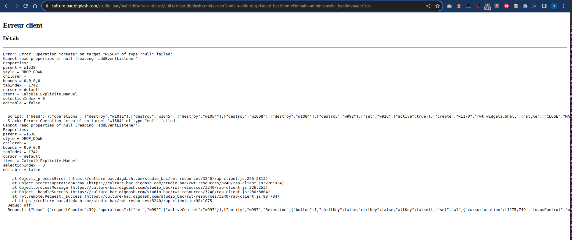

Client Error : Cannot read properties of undefined [message #1862501] Thu, 07 December 2023 10:28 Go to next message
Hello everyone,
We are asking for your help because we are facing a bug whose origin and cause we have no control over.
This is a client-side crash that appears to be related to Combo instantiation.
The oldest occurrences of this problem, on our side, date back to June 2022 (RAP 3.20), and from time to time until today (RAP 3.25).
The application crashes on the browser side, with an error message which is always similar although never exactly the same:
Error: Error: Operation "create" on target "w6866" of type "rwt.widgets.Combo" failed:
Cannot read properties of undefined (reading 'setVisibleItemCount')
Error: Error: Operation "create" on target "w11740" of type "rwt.widgets.Combo" failed:
Cannot read properties of undefined (reading 'setItems')
index.php/fa/43784/0/

Hi again,
we are starting to make progress !
I managed to reproduce the crash with a potentially wobbly UI (I'll search next after what makes my UI not compliant to the RAP framework).
I used the developper mode (-Dorg.eclipse.rap.rwt.developmentMode=true) to get a readable rap-client.js
With a "pause on caught exceptions" breakpoint, I stopped into the following code.
The crash occurs on last line : parentFocusRoot is null.
I hope it's usefull !
rwt.widgets.DropDown = function( args ) {
    this._ = {};
    this._.hScroll = !!args.hScroll;
    this._.hideTimer = new rwt.client.Timer( 0 );
    this._.hideTimer.addEventListener( "interval", checkFocus, this );
    this._.parent = args.parent;
    this._.appearance = args.appearance;
    this._.customVariant = null;
    this._.styleMap = null;
    this._.popup = createPopup( args.appearance ); // TODO: create on demand
    this._.grid = createGrid( this._.popup, !!args.markupEnabled, args.appearance );
    inheritParentStyling.call( this );
    this._.visibleItemCount = 5;
    this._.items = [];
    this._.columns = null;
    this._.inMouseSelection = false;
    this._.visibility = false;
    this._.minWidth = 0;
    this._.selectionWrapping = true;
    this._.events = createEventsMap();
    addParentListeners.call( this );
    addGridListeners.call( this );
    this._.popup.addEventListener( "appear", onAppear, this );
    this._.parentFocusRoot = args.parent.getFocusRoot();
    this._.parentFocusRoot.addEventListener( "changeFocusedChild", onFocusChange, this );
