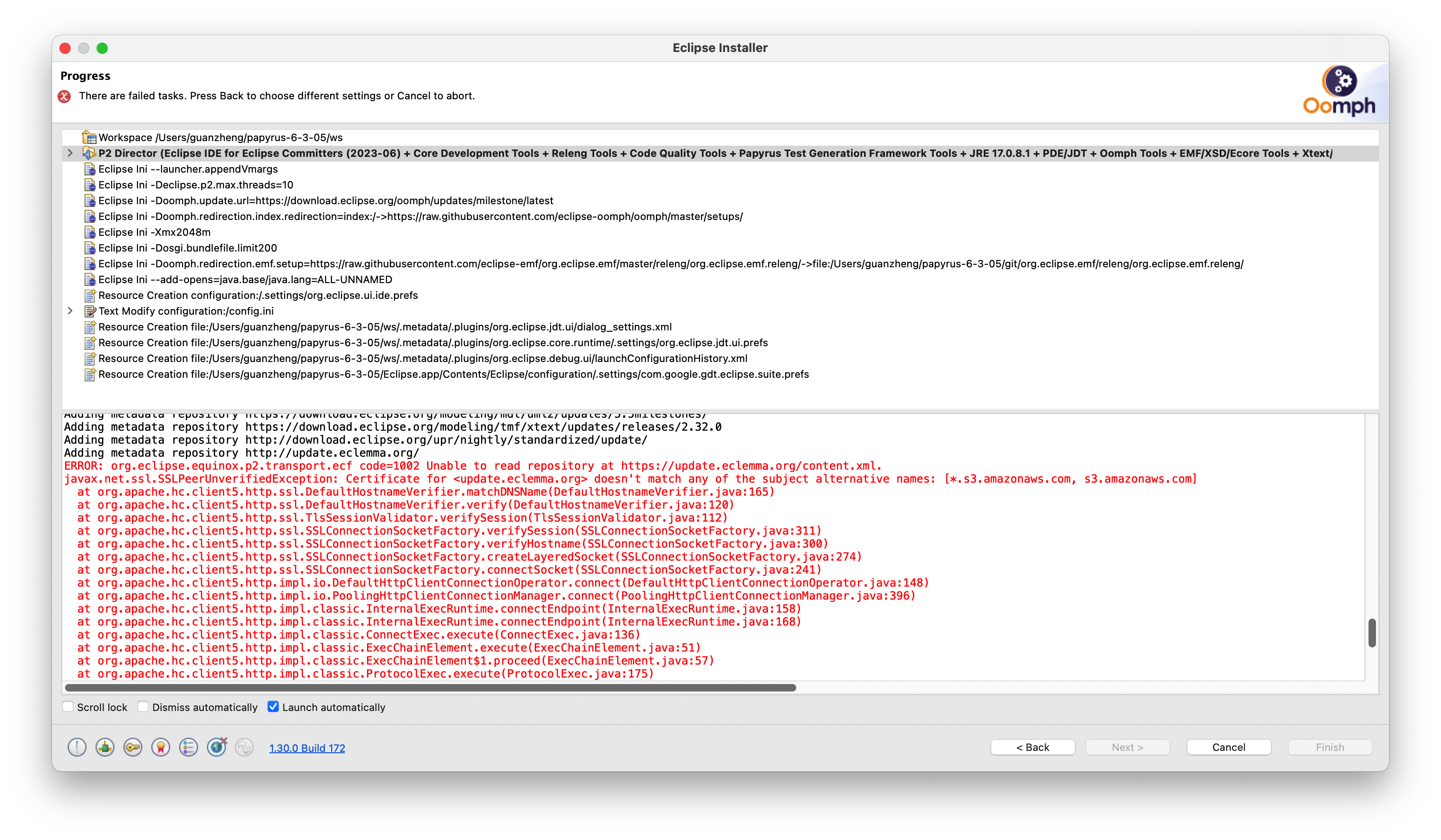

## Steps to reproduce
1. Install the Oomph installer
2. Follow the guide of Papyrus_Developer_Guide/Papyrus_With_Oomph
3. Choose the "Eclipse IDE for Committers" package to install.
4. Click the Oomph package.
5. Click Next and Finish.
6. The error reproduced.
## What is the current bug behavior?
Install failed.
## What is the expected correct behavior?
Install the papyrus environment successfully.
## Relevant logs and/or screenshots
index.php/fa/43754/0/
  • Attachment: bug.jpg
    (Size: 2.22MB, Downloaded 260 times)

This a mistake liked to Eclemma. I think that the server was not available at this moment. you could retry your installation.
Patrick

I've encountered a similar error, but not exactly the same: the Oomph installer fails trying to contact http://download.eclipse.org/upr/nightly/standardized/update, and indeed, that site seems not to exist anymore (I get a 404). Note that this url is an http. I also tried contacting the same with https but it doesn't exist either.
Furthermore, it appears that the Oomph model has not been updated since 6.3 / 2022-12.
Any chance this can be fixed soon?

UPR seems not existing in eclipse anymore. Indeed, we should update the oomph model.
Pauline
