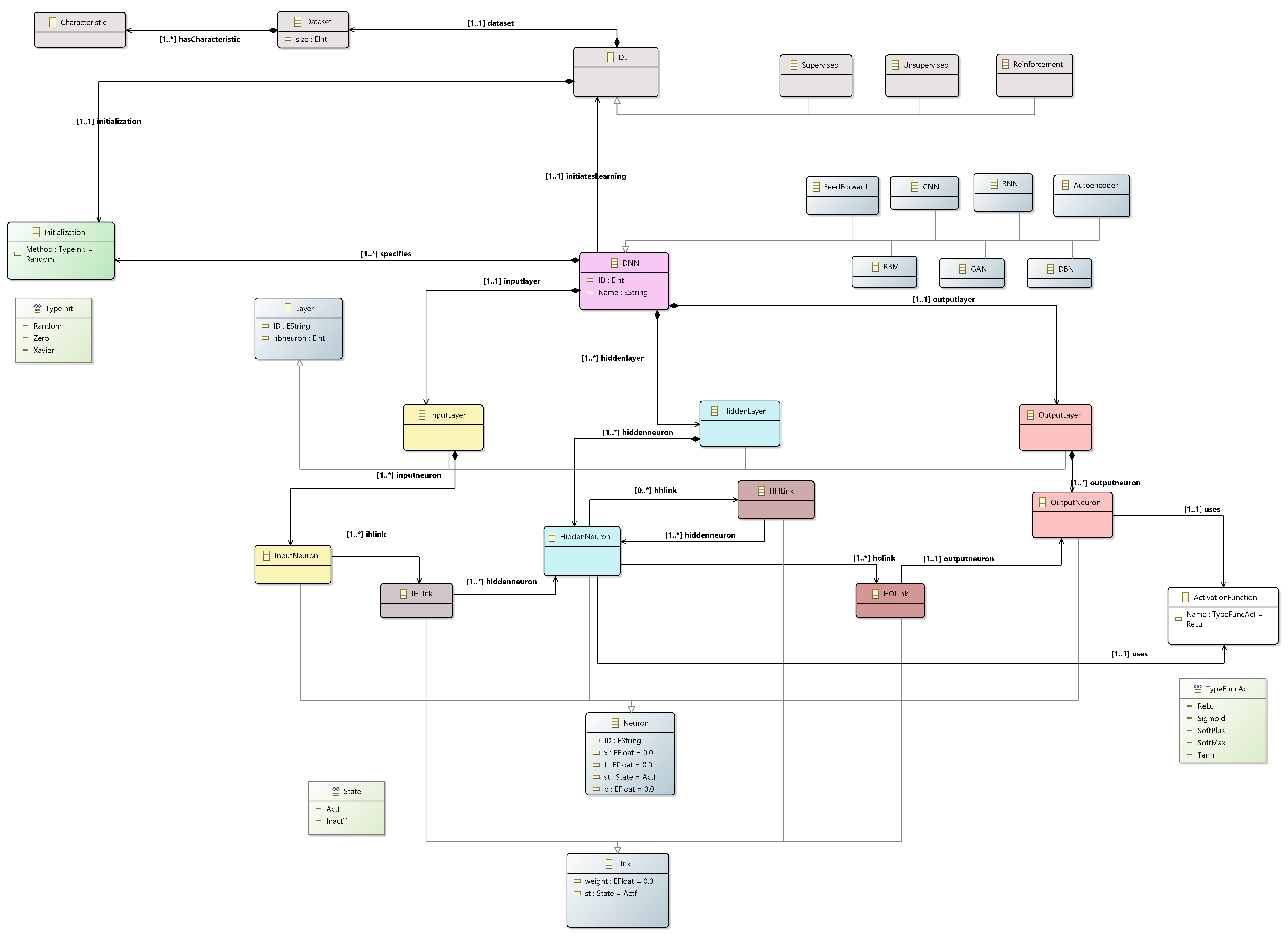

index.php/fa/43693/0/I have created a metamodel for Deep Neural Networks (DNN) in Eclipse using the Ecore modeling tool.
After creation, I want to transform it into a graph using the Sirius tool. I have been able to create the neurons and layers, but I have not succeeded in establishing the links between the neurons. I don't know what the problem is. Below, you will find my metamodel, the XML code, and also the graph.
Another question: I have modeled the structure and behavior of my DNN, but in the graph, I want to focus only on the structure. Is this possible?
