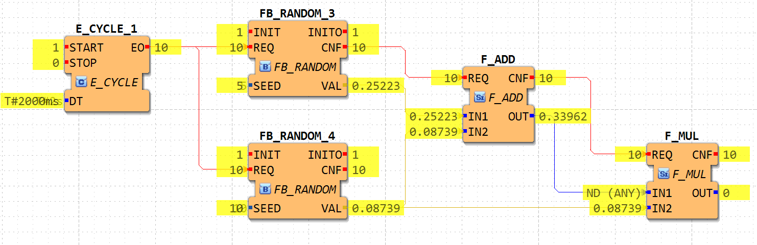

Hi, I am trying to create an application using FBs such as F_ADD, F_MUL, and F_MULTIME. I discovered that when an output of these FBs is ANY, it can't somehow transfer that signal to other FBs using ANY input. What should I do now? Is there any configuration might affect this result?

In 2.0.1 ANYs need to be "force-typified" with the concrete expected type.
So if you have TIME as a result you need a TIME2TIME FB between the ANY output providing the TIME value und the ANY input consuming it
