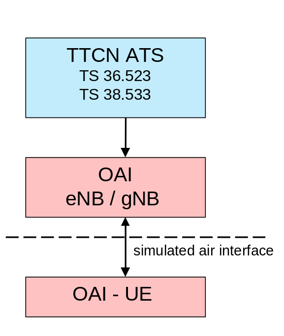

I am investigating whether it would be feasible or of interest to develop a SW only framework based on the OpenAirInterface (OAI) SW for testing the 4G/5G TTCN code when when it is updated with corrections, new test cases , or upgraded to a new 3GPP release.
index.php/fa/43608/0/
My question: Is out there a group working in such a framework interested in sharing efforts?
Different parties will have different focus: Verifying or experimenting with eNB code, verifying UE implementation. Our focus is TTCN code verification using the Titan compiler.
Olaf

We generally stay away from OAI as it is not an open source license, but a "shared source" or "source available" license which discriminates between different groups of users (research/academia vs. others)
In terms of using the 3GPP-specified TTCN3 code for UE testing against a FOSS implementation of a UE, my company sysmocom supported Software Radio Systems a few years back to run it against their srsUE. I don't know where they keep the code and whether it's maintained today, but there is public record about it at https://twitter.com/SrsSystems/status/1223948636830281729 so I can mention it. I'm happy to reach out to SRS to check the status and/or availability of it.
Their approach was not to run a full eNB at the time, but really just to build the (I think called) "system adapter" as mandated by the spec. It's really only a tightly controlled subset of an eNB, as far as I recall it.
Unrelated to UE testing: Within Osmocom, we developed some [very basic] test cases against a number of 4G EPC elements and run those as part of our continuous integration suite against open5gs (a true open source implementation of 4G EPC + 5GC), see
* https://jenkins.osmocom.org/jenkins/job/ttcn3-mme-test-ogs/test_results_analyzer/
* https://jenkins.osmocom.org/jenkins/job/ttcn3-hss-test-ogs/test_results_analyzer/
* https://jenkins.osmocom.org/jenkins/job/ttcn3-ggsn-test-ogs/test_results_analyzer/
* https://jenkins.osmocom.org/jenkins/job/ttcn3-pgw-test/test_results_analyzer/
* https://jenkins.osmocom.org/jenkins/job/ttcn3-upf-test/test_results_analyzer/
All the above tests are in https://gitea.osmocom.org/ttcn3/osmo-ttcn3-hacks
