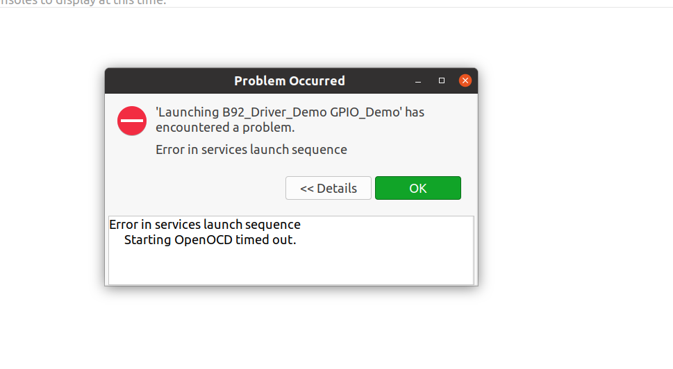

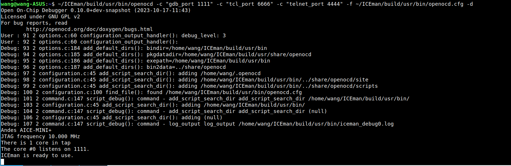

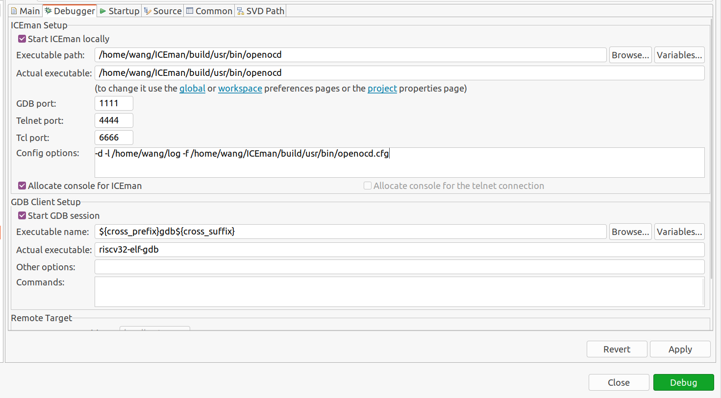

I used a modified openocd and tried to start openocd for debugging through CDT, but I received a timeout error and the console did not provide any output. But it can be started in the shell with the same commands and parameters. And when I intentionally pass in the wrong parameters to cause my OpenOCD to exit abnormally, the console can output a complete log.
My OpenOCD will eventually run to the server_loop(), blocked by select(), which is consistent with the official openocd. In my testing, after the CDT called openocd, my openocd did indeed run to the server_loop().
So how does CDT determine whether OpenOCD has been successfully started? Where may the problem be?
