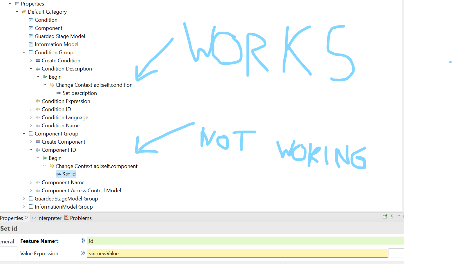

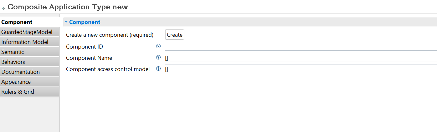

I have a situation where I need an instance of multiples classes that do not have a visual representation. In order to acheive this, I have set the root element of the editor as the highest class in the hierarchy and have set each class below it as a page in the proerties tab in order to create them and edit their properties. These pages allow me to create the instances of the classes but not edit their properties.
The way I do it is that I have a create button that creates the instance (by calling a java service), and then I have text fields with a change context and a set operation. It seems that the change context does not get evaluated properly as I get an error that says that the property that I am trying to edit does not exist on the root element. I am pretty sure that the expression in my change context is correct (aql:self.component).
This is very odd because I have the exact same situation somewhere else in the editor and I am able to acheive what I want there, but not here. I have attached a few pictures to show what I have, any help would be greatly appreciated.
