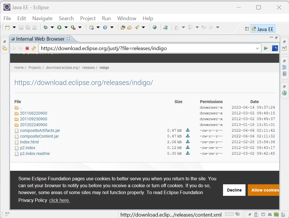

Re: Eclipse Indogo marketplace [message #1860791 is a reply to message #1860785] Sun, 03 September 2023 13:41 Go to previous messageGo to next message
Hi Merks,
Thanks for the reply,
I was trying to install Egit plugin: https://download.eclipse.org/egit/updates And there was no /api/p for it, is there any other workaround?
Note:
I was initially trying to install indigo plugins in eclipse indigo, and it was throwing this error:
Message Unable to read repository at http://download.eclipse.org/releases/indigo/content.xml.

Re: Eclipse Indogo marketplace [message #1860801 is a reply to message #1860791] Mon, 04 September 2023 02:11 Go to previous messageGo to next message
Are you within a firewall that might be blocking access?
You can use a URI like this to browse the raw contents of the download.eclipse.org server:
https://download.eclipse.org/justj/?file=
E.g.,
https://download.eclipse.org/justj/?file=releases/indigo
There is a repository at that location, but it's a composite that reference other repositories, e.g.,
https://download.eclipse.org/justj/?file=releases/indigo/201202240900
So you might try https://download.eclipse.org/releases/indigo/201202240900/ or http://download.eclipse.org/releases/indigo/201202240900/ with and without https.
Re: Eclipse Indogo marketplace [message #1860816 is a reply to message #1860801] Mon, 04 September 2023 11:15 Go to previous messageGo to next message
I don't think it's the firewall, as I am able to access this
https://download.eclipse.org/justj/?file=releases/indigo/201202240900 from both the browser and the eclipse browser. I have attached an image of it.
Re: Eclipse Indogo marketplace [message #1860826 is a reply to message #1860816] Tue, 05 September 2023 01:45 Go to previous message
I've offered all the advice that I have. If both https://download.eclipse.org/releases/indigo/201202240900/ and http://download.eclipse.org/releases/indigo/201202240900/ don't work then it's not going to work.
