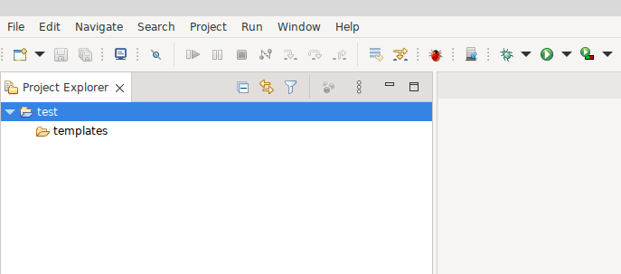

Starting with eclipse version 2023-06, the folders in a specific project containing german umlauts (like öäü) are not shown any more.

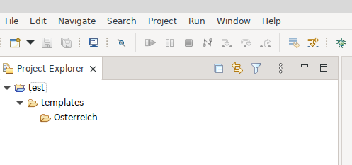

A test with the same project in 2023-03 shows the folders.

Steps to reproduce:
Download a clean version of eclipse java IDE version 2023-03, start a new workspace, check locale in General -> Workspace settings.
Add a new test project (General project, no Java). Add a folder named "Österreich".
Start eclipse 2023-06 with the same settings and select the same workspace. (accept conversion to newer version)
Navigate in project explorer to the test project (which is initially showing the folder) and press F5/Refresh.
The Österreich folder disappears from view.
