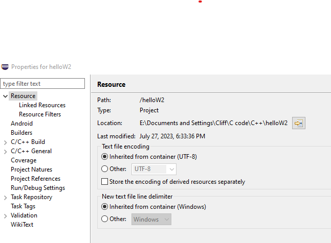

I doubt it's line endings problems. The file might be UTF-8 encoded and you copied to a project that is windows-1252 encoded, which I think is still the default on Windows; look in the Properties... -> Resource from the project's context menu at that of the file itself. Are the files really byte-for-byte identical? In that case I seems to me it can only be an encoding problem...

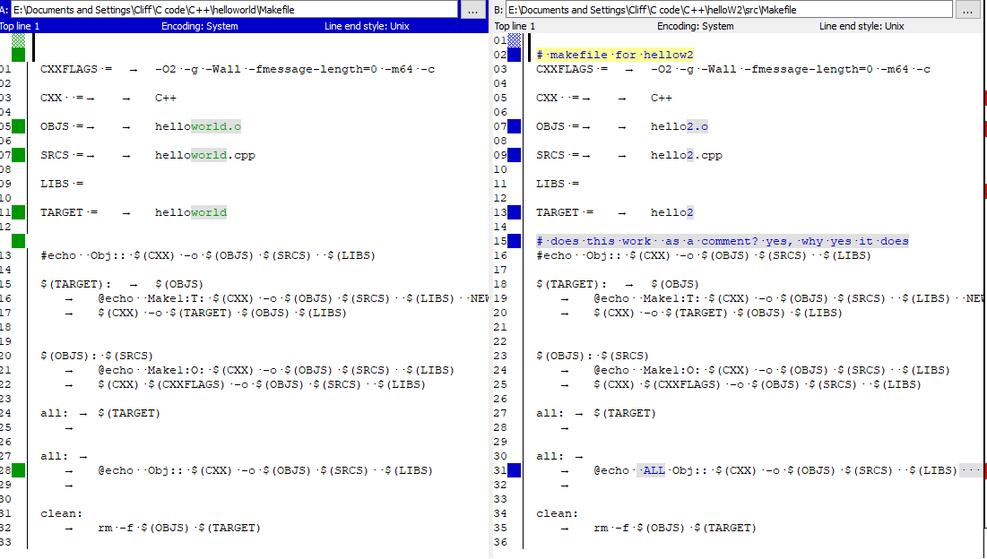

Re: Multiple makefile errors only in Eclipse [message #1860542 is a reply to message #1860535] Mon, 14 August 2023 15:19 Go to previous messageGo to next message
Seam the same to me. Attached eclpise1 is the one that does not work and eclipse2 is the one that does.

The diff is the diff between the two makefiles.

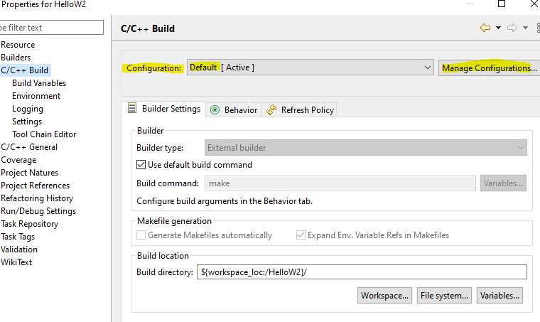

OK I found the problem! (I think?)
See eclipse3
There is a Debug(now Default) directory and the makefile in that dir. is the problem.

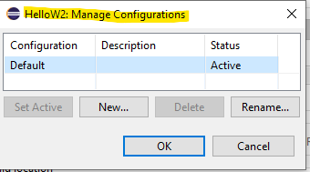

I deleted the Debug dir. and ran the project. The Debug file reappears and I get the same errors. Under the projects->Environment I changed the CWD & PWD to be helloW2.
They remain as I set them. In the Configuration box (eclipse4) was set to 'Debug' was active. I made a new one 'Default'(eclipse5) and deleted the Debug one.
No Joy!
It still creates the a directory, now called, 'Defaults' with the same results.
How do I change the configuration? The configuration under the run+ does not change it. There is no Edit in the 'manage configurations' screen.

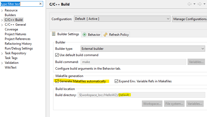

Update2: see eclipse6.
The Debug/Defaults directory is the result of having the 'Generate Makefiles automatically' check box in the D/D++ Build page(eclipse6).
Now, why the Eclipse generated make files fail, is another question.
