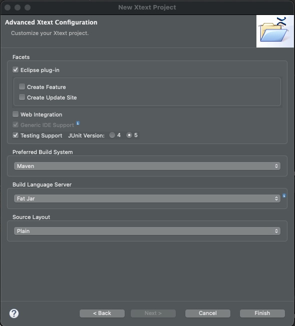

Re: Configure Standalone [message #1860550 is a reply to message #1860524] Tue, 15 August 2023 12:24 Go to previous messageGo to next message
Thank you! I created a new project with FAT JAR. Then follow run>maven install on the parent folder, add the JAR under org.xtext.example.mydsl/target and now I can recognise the DSL classes on Maven.

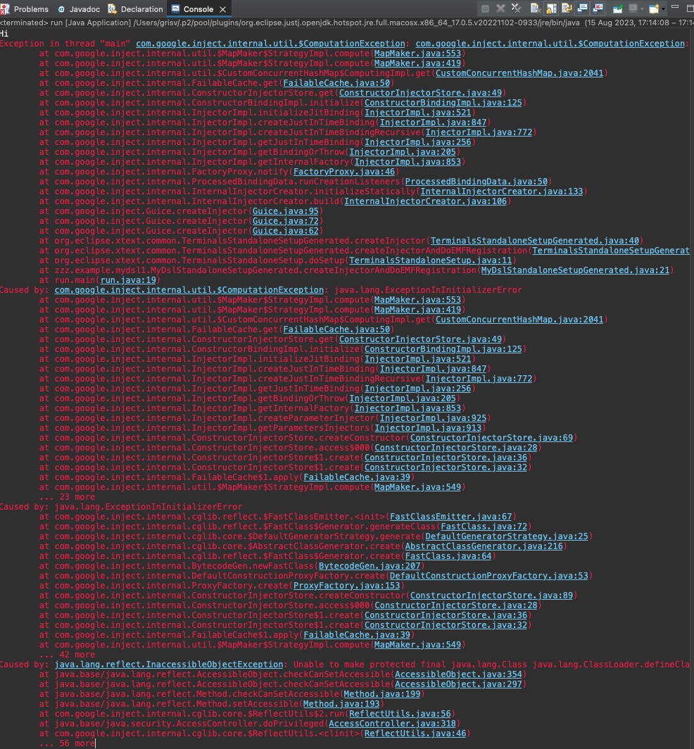

However, when I run the main.java in Maven there are lots of errors related to the line:
Injector injector = new MyDslStandaloneSetup().createInjectorAndDoEMFRegistration();
Do you have any idea what this error mean/ how to solve it?

Re: Configure Standalone [message #1860559 is a reply to message #1860550] Wed, 16 August 2023 23:38 Go to previous messageGo to next message
Can you provide complete error log
Re: Configure Standalone [message #1860566 is a reply to message #1860559] Thu, 17 August 2023 07:23 Go to previous messageGo to next message
Yes, I share all the code and error I got here: https://github.com/Gricel-lee/Xtext-Maven
Thank you!

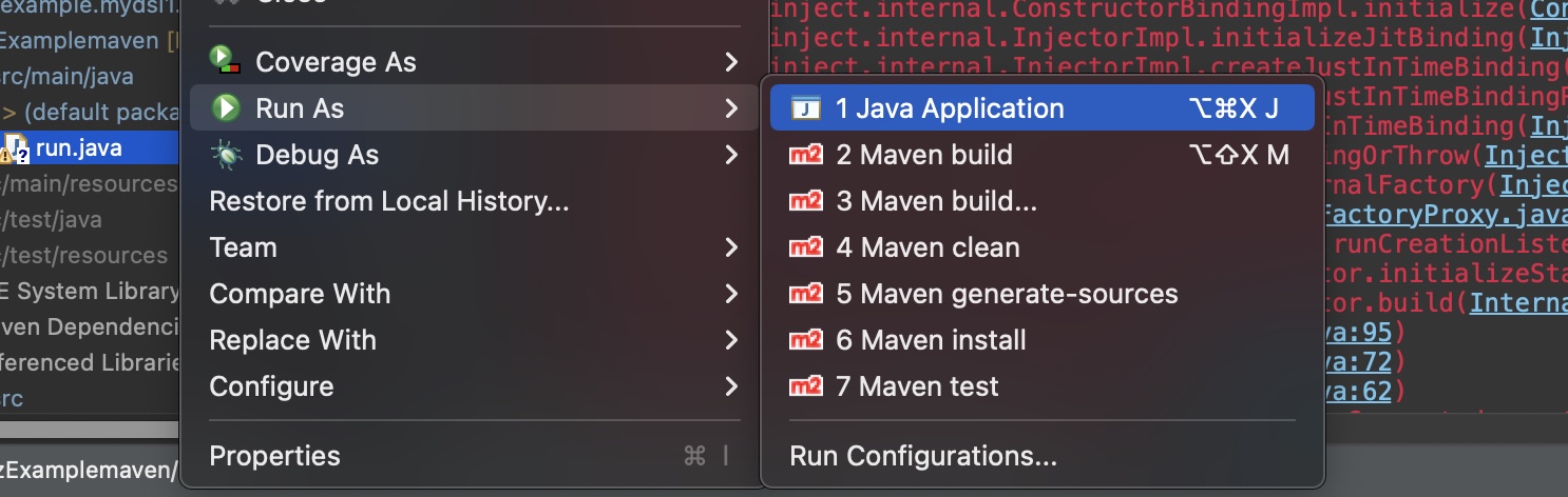

What do you mean by run
How do you execute the jar
And the run thing
Maybe using the default package is a bad idea with java 17 and modules

Re: Configure Standalone [message #1860573 is a reply to message #1860572] Thu, 17 August 2023 17:11 Go to previous messageGo to next message
I have the .JAR file located under zzz.example.mydsl1/target as a project's dependency in Maven.
By run I mean I run the main class in my Maven project as a Java application.
I changed the name of the package, but same error.

Re: Configure Standalone [message #1860602 is a reply to message #1860574] Mon, 21 August 2023 06:39 Go to previous messageGo to next message
Well, I still stuck here after trying multiple configurations of the version in the .pom file and Java,
but thank you for the help!
Re: Configure Standalone [message #1860616 is a reply to message #1860602] Mon, 21 August 2023 23:21 Go to previous message
questions:
- why do you use the normal jar and not the uber jar
- file should be "./example.mydsl1"
- other xtext deps in example project not needed
=> unclear what you try to achieve
maybe you can do 2 steps back and describe what you want to achieve
with move of run.java to a package
it works for me
